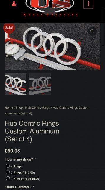

Measure on your forgestar as well with calipers, please. I had special rings made, were $100 for a set of 4. Look at what the hub says on my box. That’s not the hellcat hub size. They 100% do not sit on the hub.

I used US wheel adapters. They had the forgestar wheels in their system already so knew the size, found the email.

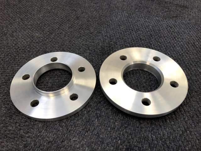

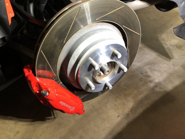

Here’s the ones I made, they locate the rim same as stock does. These are custom diameter hub centric pilot for Race Star rims. I made a few sets in different widths, 10, 14, 18mm, work great.

I had stock bore hub centric spacers made (with the lip) and then got the rings made for the inside of my forgestar wheels. This way I can use the spacers with my stock wheels still
