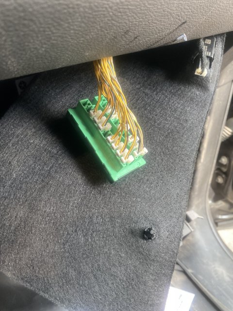

Need help finding these white connectors they are female and go to the star connector on Chrysler vehicle,for the communication of the module’s 71450514126__54FDFF8C-2183-4A32-BF78-30E11C12ABD1.jpeg 64e6430f6e3de0.87822986.jpeg

They’re on the connector repair site, look up star connector. Also, older hellcats come with an extra one and cars that don’t have adaptive cruise control, so just cut the “spare” one off under the glove box

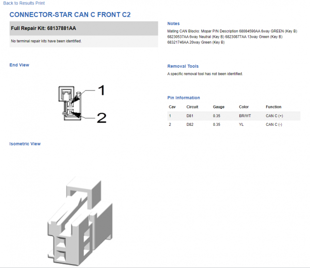

PLEASE BOOKMARK THE FOLLOWING SITE IT HAS EVERY CONNECTOR FROM MOPAR https://connectorrepairkit.mopar.com/ IF YOU HAVE TECH-AUTHORITY IT WILL LINK YOU TO THIS SITE BY DEFAULT.
NOT ALL CONNECTORS ON THE CANBUS ARE THE SAME.
1.) it is called the STAR CAN connector.
2.) second there are two pin (devices) and three pin (bus to pcm) ports
Filter by year and vehicle then type "star can" in the filter and you will get parts like this:
I HOPE THIS HELPS YOU GLASSES NEEDING MOFO CONFIRM FITMENT FROM YOUR YEAR.
