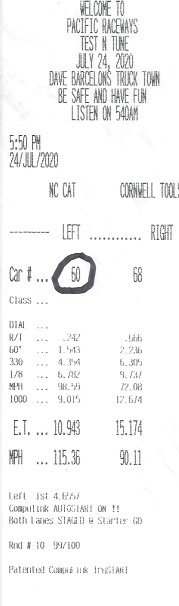

pulled a PB last night did a 10.9 and a1.54 second 60' and my trap speed sucked
115 mph couldn't understand that low of speed until I popped hood

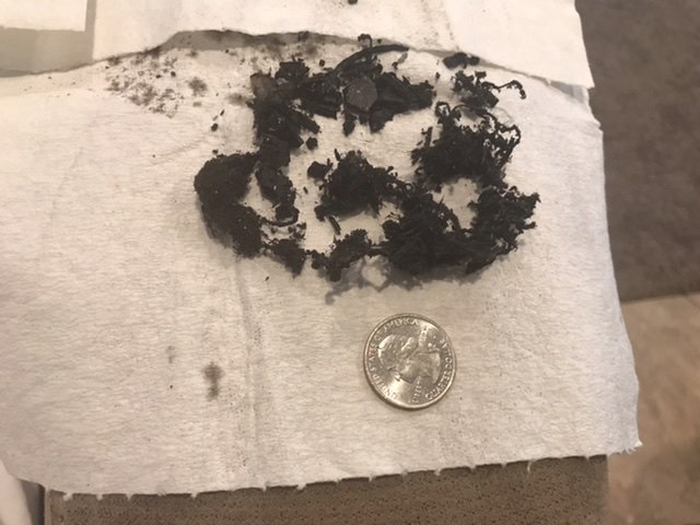

Yes belt shredding was not good sucked pieces of belt into Procharger tried to get it all out but after new belt picked up a miss at last half of track but by the time I pulled into pits it was running good thinking some got in motor pulled plugs today compression good 180-190 cold so tomorrow l will pull intercooler and clean out

Pulled the intercooler today found just a little bit in it (ha ha )
as far as belt ran a straight edge across pulleys they looked perfect
stood there and the studied the pulleys noticed tensioner pulley
outside edge on pulley was real thin the other pulleys Had a fat edge
it only was a matter of a little over a 1/16 of a inch
hoping that’s all the problem was it’s not a lot but hoping

You mean that went through the procharger and was caught on the intercooler grid?
Chuck
Chuck
#1072
152
160
Auburn
2021 Redeye Super Stock
Part of it went all the way through inter cooler and I believe that’s what caused miss in engine for 3 minutes or so at end of track but it cleared up
if you looked in bottom of intercooler you really couldn’t see anything
so I made a blower pipe so I could go through the top and blow downward
all the across Top hopefully I got it all
