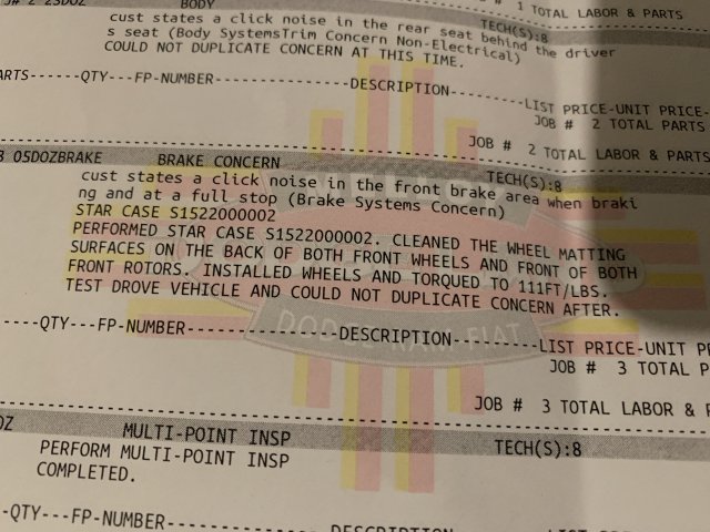

So I did have my car looked at yesterday, they performed this TSB on the front brakes are they are not clicking anymore fwiw.
Noise behind me was just the seatbelt knocking against my son’s booster seat in the back. No issue there. No more weird sounds for me right now...

Just an update, my car is making the same noises it always has, seems like a little click or knock from the front brakes, and then something coming from the rear seat belt by my son's toddler seat.
I absolutely do not have an engine tick, listened for it several times. Definitely no engine tick.
