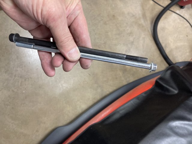

I installed mine over the weekend while replacing bearings and changing to a 2.72 pulley. Here’s a picture of 0D29C57E-B407-4C9A-B34E-87117592A5D3.jpeg 6B759B44-07E6-462D-A53B-560813525DE7.jpeg D7ACB8BC-6E3E-42D5-8F61-42A8FCEAC63F.jpeg how much longer then the socket head cap screws sent. They look Great installed as well, Good stuff 👍👍

I installed mine over the weekend while replacing bearings and changing to a 2.72 pulley. Here’s a picture of View attachment 66653 View attachment 66654 View attachment 66655 how much longer then the socket head cap screws sent. They look Great installed as well, Good stuff 👍👍[/QUOTE
Awesome. They really do look a lot better than the socket headed bolts. I’m happy you like them!
