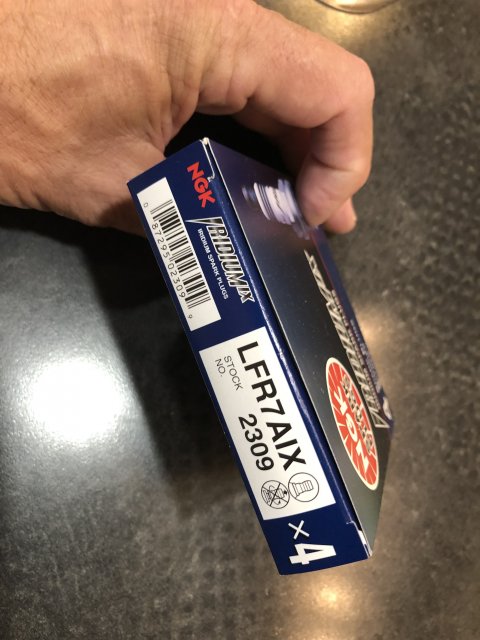

Ngk 2309 vs 7aix+11?

I think they are the same plug. One comes gapped at .031 and the other one is gapped at .045 or so.
How are you gapping iridium plugs?
I know to stay away from the center electrode.

Did you gap them smaller or kept them at .031? Brisks keep fouling out.

THEY ARE AT STOCK RECOMENDATIONS

WHATS YOUR SET UP??

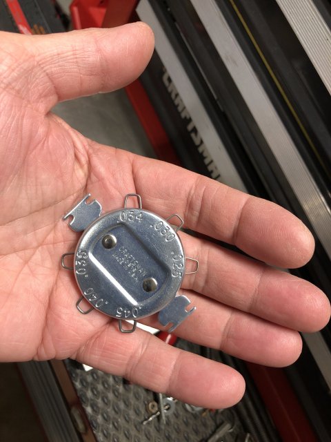

Use a ground strap bending tool to close and square the gap to .028”. Don’t use the electrode as a pry point ever, the iridium tip Tiny and very fragile

Can you recommend a good ground strap bending tool? Yes fragile and brittle. My setup is stated above. 955 hp, 1010 torque. About to add emp tank in trunk as that will add further cooling.

I use this Craftsman one, #40816
3,319
7,831
I use 2 together, one to hold and one to make the tweak with

More then 18 psi of boost I was told by Tuners to go down to .025”, above 22 .023”. Don’t know about E85 though

I bought a adjuster. Pretty cool. 14 mm. You screw in the plug. Then on the other end you slowly tighten a smidge at a time until the ground strap touches the feeler gauge. With me I am going to take the extra step by not compressing it with the feeler gauge in it.
