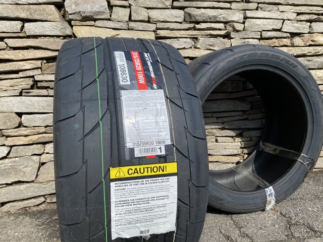

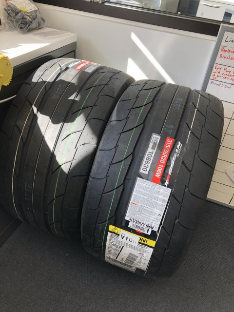

Mine arrived today, so did the new 11” rims, unfortunately rims don’t color match worth a crap and are going back. Now waiting on different brand rim, so be next week for me now before I can review them against a 315 NT05R that are on my car now View attachment 17367 View attachment 17368 View attachment 17369

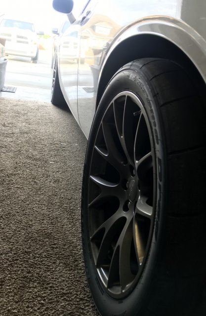

I run a 315 NT05R on a 10.5” Brass Monkey replica +25 on my 16 and their a perfect match fit and form. Trying the new NT555R2’s soon as another set of replicas arrive to test them against one another on the street.

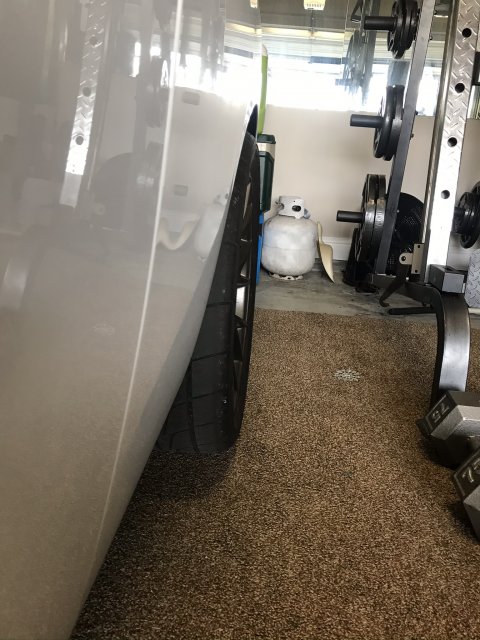

View attachment 17448 View attachment 17449
No rubbing or nothing? I've got a 2016 as well and just ordered the 10.5 replicas. I was going to order the 305's. Its probably a dumb question but how much more actual contact patch does the 315 give over the 305? Just curious...

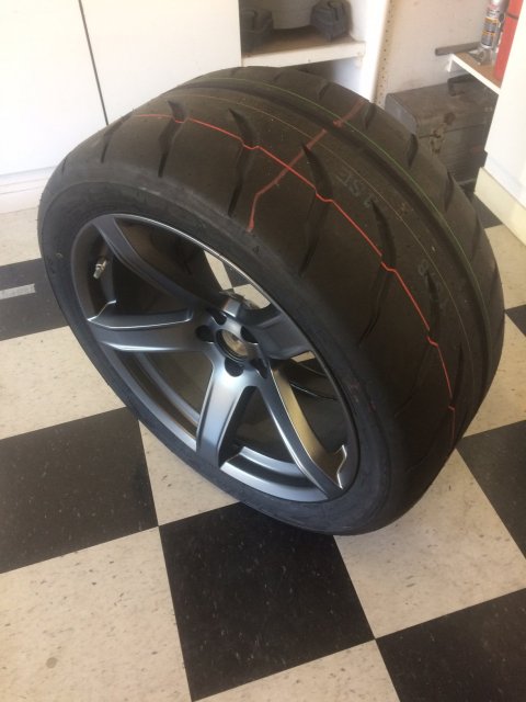

Since no one seems to be able to match the matte vapor color I had my factory rears widened to 10.5 " Toyo
R888R in this pic, wore those out in 4000 miles , now running Nitto 555R

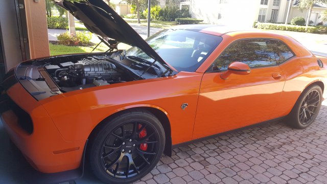

I've ran 305/35 555R on stock rim 16 HC Challenger for 3+ years, driving in FL rainstorms, 100+ mph many, many times. No problems whatsoever. Unbelievable difference compared to stock summer garbage Pirellis. 20200119_105803.jpg
