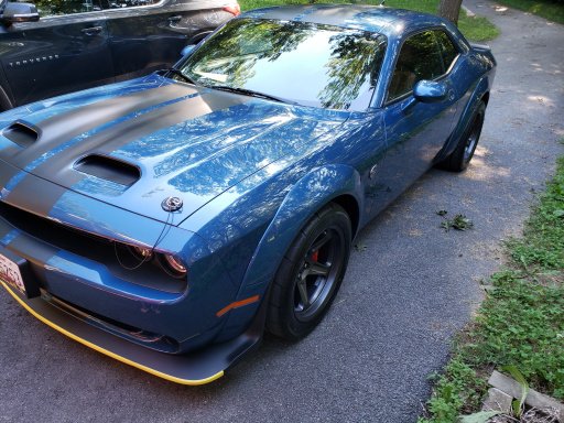

My dad passed away several years ago
His best friend came over for our annual birthday drinks & do some reminiscing ( I needed spell check for that 1 ) as we do every year
Him & my dad share the same birthday
Too many Canadian whiskeys later he got up & stumbled into the car
The big dent you see center left was the result
He also pushed the fender in a fair amount
The panels on this thing are paper thin
After 1 week of punching shit that cost me more money ( not the car ) I went back & starred at the Fender contemplating a plan
So what you see here
I stuffed my handy cardboard Beer can separator between the panels
Then I drilled a hole in the Fender knowing it was not repairable & I was replacing it
Then I pulled the Fender out with the 90 degree tool so I could open the door safely
Had I opened the door with the Fender pushed in I would be repairing 2 panels
Then off to a buddy of mine that owns an upfitter shop
Luckily his main customers over the years were Chargers & Challengers
Aside for a scratched fastener the replacement Fender fits better then the 1 on the opposite side
THE END
