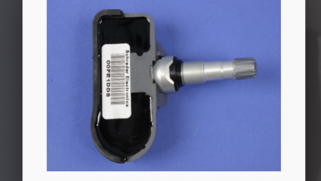

Here’s a picture of one, see how their clipped together? I had a new one come apart in my hand installing it. I’ll have a new one in hand in a few days, tired will be here next week as well

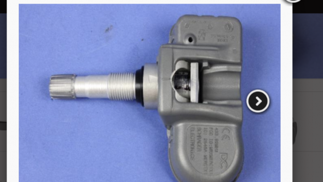

Another pic of back side, sensor just slides onto that flat clip, held in place by rim once installed
I just installed 6 of these and they do not just clip together. So, I have no idea what you are talking about. Please, be sure and show us pics when you get the tire dismounted.

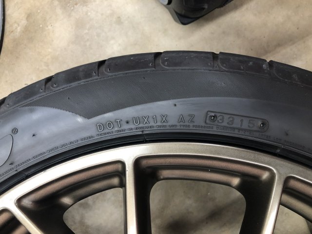

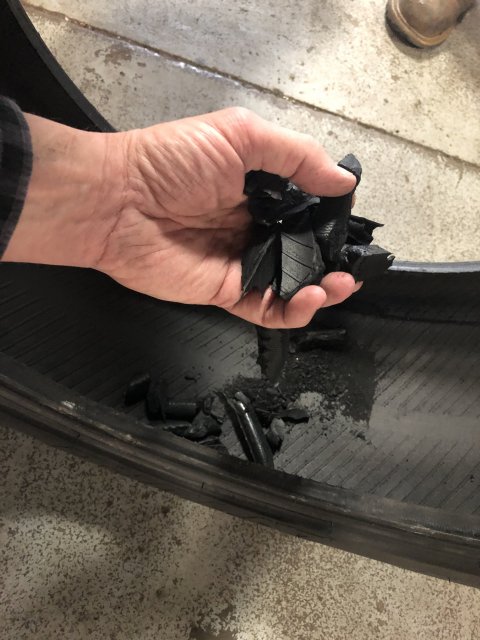

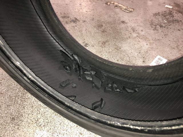

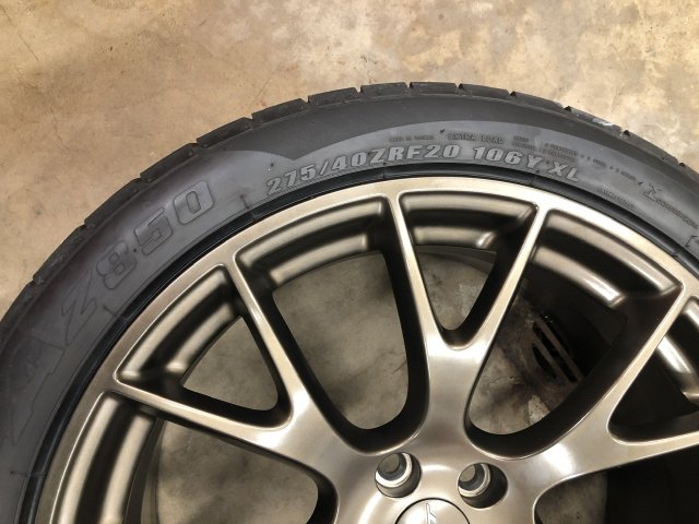

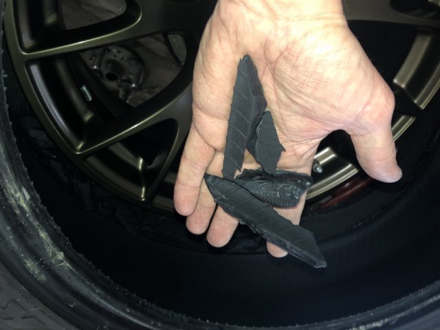

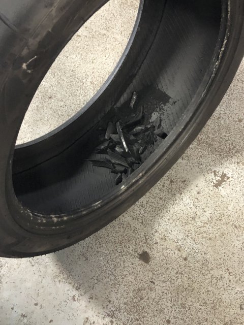

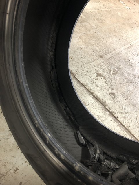

Turns out TPMS sensor was intact, tire was literally shredded inside, manager of 25+ years at this large tire facility never saw anything like this before. Man am I lucky I didn’t have a blow out at 175+. Moral of this story, NEVER assume something as critical as a tire problem, it could cost you dearly.
New Nitto 555GII’s went on this weekend.
DB748491-37AB-4CA7-AD1F-04D1E3DE83E1.jpeg 4BA0EC49-BA6C-4ABD-B307-ADDCB5730A4D.jpeg 2E698B79-0FA6-469F-94FE-04127A095891.jpeg C7202579-7751-4E9E-8F5A-94FE9144B638.jpeg 26436910-8FEA-4961-8E4B-0F6BF1D85530.jpeg E3801B33-0BA7-41C5-93B6-3439C0EEE198.jpeg
20,161
That's some scarry stuff right there. No curb or other impact that you're aware of? Manufacturing defect is my bet then.
3,794
8,977
Thread Starter #34
Nope, not since I owned it, but the front tires where on the car when I got it, 2015 date code on them. That was the inside edge of the tire not the outside

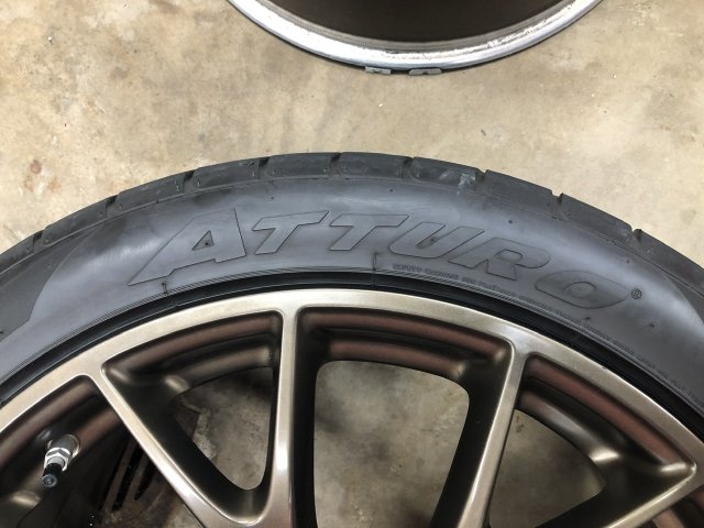

What brand was that tire?
Shit brand lol, I don’t recommend them
