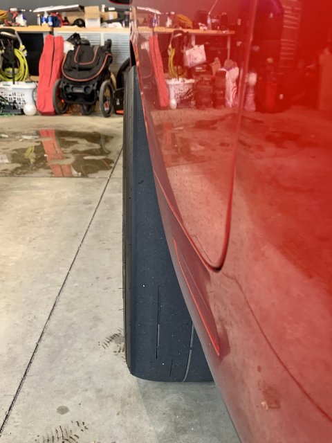

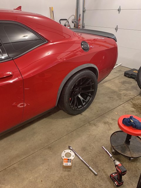

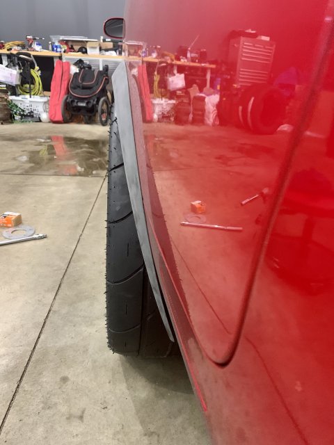

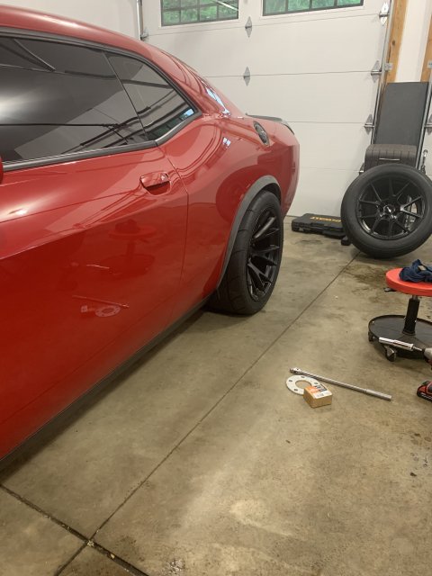

In case anyone is wondering what this looks like, I’m trying out the Lil devils with WB wheels. It actually looks great in person. The pics don’t do it justice. Once I get them painted and the ZL1flaps on, I’ll post more pics. In the last 2 pics you can see what the difference in poke is with no flares and 18x10 +20 Bravado Tribute and a 305/45/18 ET R vs the flares with 20x11 -2.5 and a 305/35/20 ET SS.
FYI:The 11” WB wheels will have 6.2mm more poke than the aftermarket 11.5” wheels that Phillips recommends. It wasn’t much difference so I wanted to try this first since I haven’t seen anyone do it before. It’s an aggressive look and looks really good in person as I mentioned.

That actually looks like a good pairing. Those are factory WB rims in that pic? Cause they don't seem to poke out as much as I thought and the Phillps cover them nicely but not too much.

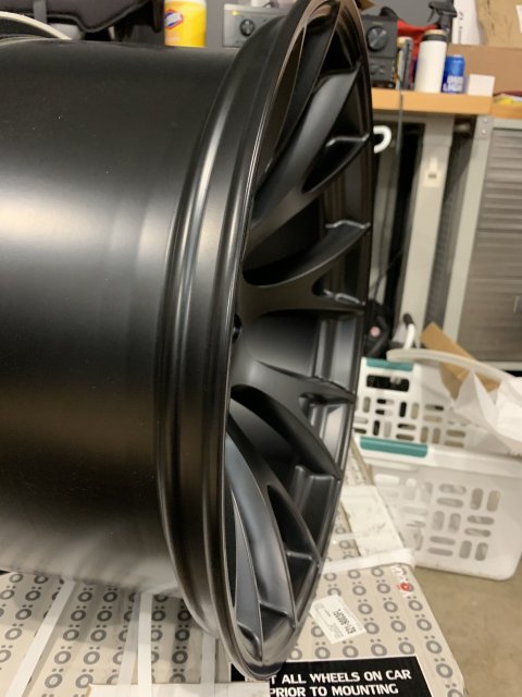

Correct, Voxx Replicas using the same OE size (20x11 -2.5). I love how concave they are which is why I wanted to try them so bad. Plus FAR less money than a forged custom set.

That looks great !!!! Please post pics when you get the flares painted !!
just to be clear, you are saying that the last photo in your post is an OEM widebody wheel?

Voxx Replicas with identical to Oem widebody specs, yes. 20x11 with -2.5mm offset. I will definitely post pics when I’m done. I’ll also be using the 20x10.5s +25 on the front with a 15mm hubcentric spacer, longer ARP studs and ET lugs. I haven’t seen anyone else run the widebody rear wheels with these flares so I figured I’d be the guinea pig!
2,381
6,598
@HellcatMatt how much space are you giving away on the inner side of the tire, against the plastic wheel well liner? Seems we would want that as close as practical.
