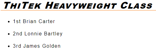

@Marc W Let me help you clean up some of the facts.....
Dave is not a stock 2.4 blower and I will not tell his secret sauce and he is unopened 6.2L engine <stock>..ALL MOTOR car.
Dave did not win the Heavy Weight class this year; Brian Carter won Heavy Weight.
@Jack_Toepfer
As far as me, I am stock blower and engine...neither have been opened. I do not have a 7L 426 or 428 like others with ported blowers or 2.7 blowers/ported on Hellcat or a big ass 4.5 whipple.
Just a stock 6.2L never opened and to my understanding, no one has gone faster on this setup. Bolt-ons and spray.
Omega set the record at 8.93 and then Chris Thomas busted it at 8.88 and then I ran 8.79.
Who else ran faster on a stock 2.4 blower and 6.2L unopened engine?
