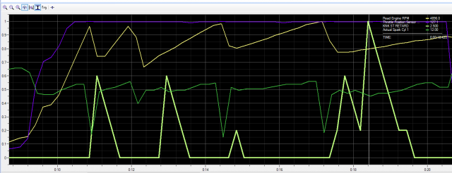

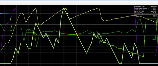

My bone stock 2016 Hellcat had a TON of STKR on 93. I data logged that car to see what it was doing and couldn't believe it. After this I always put 109 in the tank as you suggested.
Very next pass with 109 splashed in, just some blips after the shifts probably from the heat shields making noise.
Thanks for sharing that Speedy! This is very common and many people do not realize it. That is why we have cameras on the exhaust on the dyno. The detonation is very obvious when it occurs.
