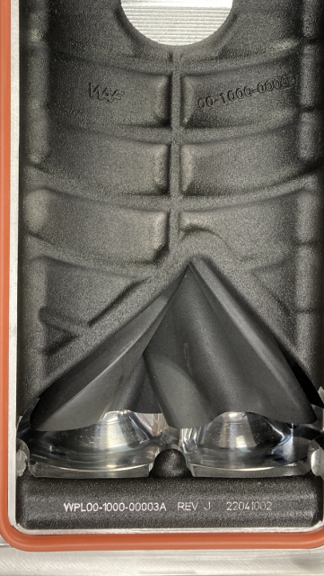

Look at the Revision on his blower, E, mine is a J, glad to see mine is newer but so many revisions already?? Sounding like IHI now with the 2.4 lol.

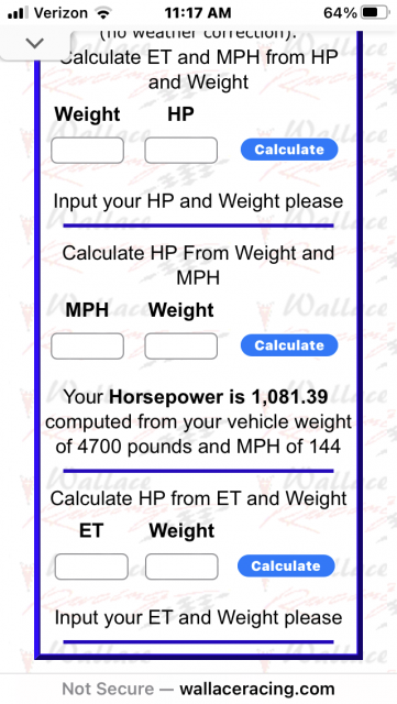

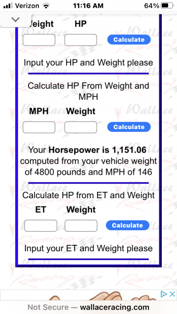

22.7-8 solid 23.6 peak in 2300 DA
RE cam and JBA 1 7/8” shorty headers through cats and stock exhaust. Estimating by 145 mph 1/4 times and 5.22 60-130 times probably around 1050-1150 wheel at the moment. Was supposed to dyno today but it’s raining here all day :(

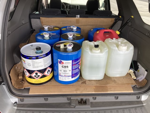

I run simple old pump flex fuel, it’s 82% at the moment, I stocked up yesterday lol. As it’s cooling off and they’ll start to dilute it with gasoline soon and raise is price. I have 100 gallons on hand now. I only run 19 degrees of max timing

How long does it take you to use that? How about staying fresh?

I treat it with 1oz per 5 gallon of Lucas E85 stabilizer, fill the containers to the brine (as little air as possible) and store in a stabile 70F dark corner of the shop. Last for a year no problem. I’ll use pump fuel first until it goes below E78 (I test every fill, even tested between every fill of every 5 gallon pail yesterday, it’s easy with my Kent Moore Fuel analyzer.
