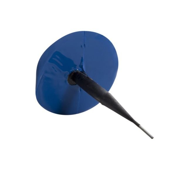

Also, the correct way is both a patch and plug in one. Grind down the inside of the tire to make a nice, clean surface, add some glue to the patch, insert from the inside and then trim the excess on the outside. Will wear and blend in on the ride home.
AeroF16
#2826
2,197
7,018
And I had never seen this before...
But then I investigated a little more and found this...
