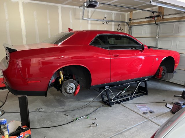

Got it up in the air today and went through it. Really happy with how this turned out, the car is in excellent shape and exactly how the seller described.
Pulled the MFERs off and a few small other things the previous owner did (tinted film on side markers, aftermarket center caps, etc.) Dropped the wheels off to get balanced and noticed a couple of the lugs are swelling.
Really happy to find the brakes are in good shape. With only 21k miles I wasn’t expecting them to be bad but you never know.
Called my local dealer to inquire about lug nuts and they wanted $16 EACH! Maybe he was confused but that was a hard pass haha.
Ordered a set of Gorilla lug nuts and Powerstop Z26s all around. Hoping swapping the pads now will increase the longevity of the rotors.

Good move on the lug nuts. When I had some PS4s put on last summer, the Discount Tire guy told me the two piece originals were prone to swelling and sold me an aftermarket set. Guess he wasn’t BS’ing.

Yeah, I had 2-3 that I could only get the socket about 1/2 of the way on. Wasn’t an issue but it definitely is worth an ounce of prevention. Imagine getting a flat tire in the middle of nowhere and not being able to get those things off.

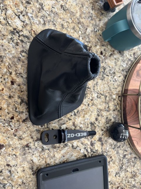

Struggling with this right now. This shift boot is not going to fit all the way over the handle and seat in that groove, not even close on mine.
What am I missing?
17,743
55,508
What am I missing?
I stuck with the O.E. stick on mine.
A suggestion would be to soak the boot in hot water for several minutes.
