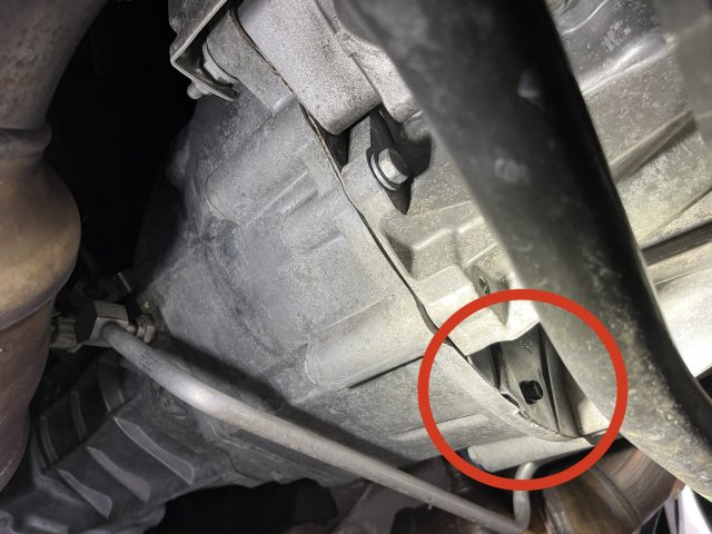

Just reached my phone under the car to snap a pic, might just be the one bolt then slides up and out. Pretty sure this will give you access to the teeth on the flywheel but I don’t remember.

It will, this is what I used for my bolt. jam a prybar in there and then yank on the flywheel bolt. Infinite wisdom before you insert new bolt in. Blow compressed air in there to clean anything out. Had to help a friend tap new threads because he just jammed a new bolt in there without cleaning it out.

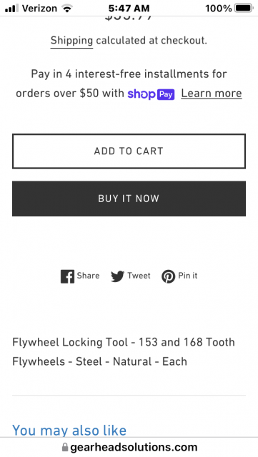

I'll try that next time under the car. Right now I'm showered and done for the day. In the meantime I found the took for 135.00, so not too bad, I guess...

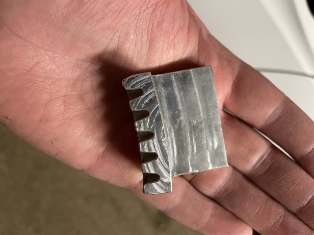

You could try this flywheel locking tool for only $35

Just bought the same tool Speedy used for a really good price so if any of you guys need it I’ll have it available to you. Thanks for the help.
