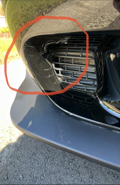

The detail shop “trimmed” these areas a couple weeks ago. They’re hard to see in the pics.
They had the nerve to ask if I wanted a Bullsh*t $75 VIP car wash. I’m thinking F U. and your vip car wash. Lol.
One of the owners is shady and a liar too. Just saying. But who isn’t nowadays.
525F585D-CED3-49F4-A815-68E623454439.jpeg F0E61BDE-1869-49C2-8E16-C309627F0452.jpeg After I get this film fixed, I’m never going back there. And they have a ton of great reviews on google and social media.

Trim that laterally with a sharp utility knife.
It will clean up, won't be white or hairy.
Taper in and out of the area, hardly noticeable

Would that even cause the PPF to come off a little?
I wouldn't think so, not where you showed the picture anyway
Look at the last 2 week old pic I posted. The PPF wasn’t installed right.
You think a black sharpie marker would work too? In that pic, you can see the scrape. And knowing how they are. They will try to charge me.

No on the Sharpie
Some certainly do, I did not, painted surfaces only.

The first pic looks like sh*t. Like a kid applied the PPF. But one of the co owners trimmed it and “fixed” it. It does look good though.
View attachment 84969 View attachment 84970 After I get this film fixed, I’m never going back there. And they have a ton of great reviews on google and social media.

That's an installation issue..not impact..to remove the scrape..use light continuous strokes with 1500/2000 grit paper lubricated with transmission oil..horizontal strokes...take your time...remember light pressure...
Thanks man. What would you do if the detailer notices and tries to charge to fix the PPF? It wasn’t applied correctly in the first place

Well ...I'm easily excitable...I'd be inclined to just cut his throat:cautious:

That lifted from some installation issues. You won't get that to restick if it's been on there a while. Best bet is to get a super sharp utility knife or knife with snap able blades to trim that. Light pressure to score the film the snap it off. That section is plastic, even if you do cut the paint, it's not going to rust.
