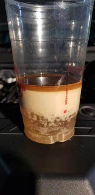

I also added the Tracy Lewis Performance (I believe is now RX) dual valve catch can to the motor, that way the catch can works whether in boost or cruising modes. When it's cool and or humid the condensation that the Air to Air exhanger puts out is crazy. It has a drain valve on the bottom of the can and you can route it for easy draining.
