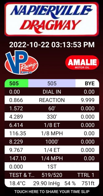

Well had an interesting day at the track today .. Still had transmission shifting issues. I was getting transmission torque management issues. . I ended up running my pump gas timing map with C16 in the tank ...
Spinning bad off the line ( see 60 foot) but the MPH was good for 12 degrees total timing up top . Once I get the transmission max torque input fixed then I can add timing..

I guess 9.7@147 is not bad for a broken car....... lol

I can't read the time slip, all blurry/small. What's it say?
Here you go Screenshot_20221023_135701_com.dynogeek.racingslips_edit_1509742665223270.jpg

147mph you might need a parachute when you sort the bugs out
