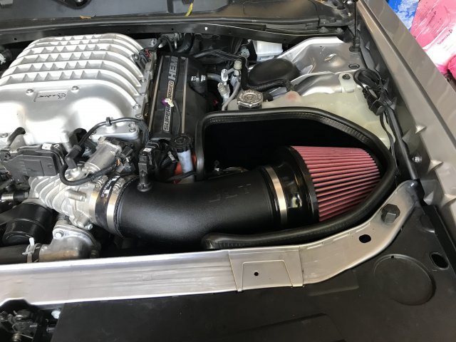

New jlt installed getting ready to install the cat deletes
@Speedy I sent you an email with the log from last night should show the info your looking for 8A14BDF4-AFFA-49C8-B90B-A6A4BAF4D730.jpeg

Shiny !!!!!!!! I want more logs lol .

I wonder if placement of the maf sensor is causing the iat to get cooler ,if it doesn't then id say because my stock blower is being spun at a faster rate now with the pulley change then its just creating more heat
