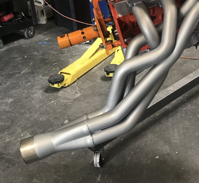

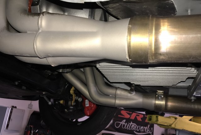

I have the AFE 2” and really like the design of the collectors. A definite merge design with a nice pyramid inside. I know the step headers are designed for na power. Not sure if that’s a good design for forced induction. You see the really high power blower cars running zoomies. Obviously just going for zero back pressure and screw any scavenging. 6DBC2795-AC9D-4732-BF54-7CE4F4EBBD44.jpeg A84B32CA-363B-45AC-A090-03A30F1C8AB0.jpeg

I like TTI headers . I have used them on many different cars . The fit and finish is always spot on . Plus I like stepped headers for a street car . They help maintain low end torque . Plus I like their over all design tube length, collector, flanges , etc .

I want the stepped header due to the low speed torque . My car spends most of the time on the street at low rpms . I will definitely post if it works or not .

I always had custom stepped headers built for both my 540” B1 nitrous motor and high rpm 412” Yates headed Windsor nitrous motor. Both also had merge collectors from Burns IIRC. I’ve been thinking about headers for my Cat, but it’s not a race car so I’m most likely not going to do it. For what I’m doing currently with the car the stock headers will suffice for now.
The guy who builds custom headers is Greg Holman in Kingman, Arizona. Probably THE best in the US.

Haha. I used to work with Steve Burns at Jardine Headers. He went on to start Burns Stainless. He provided me with the pieces I needed to build a set of stepped headers for my Renegade class Mustang some years ago.
