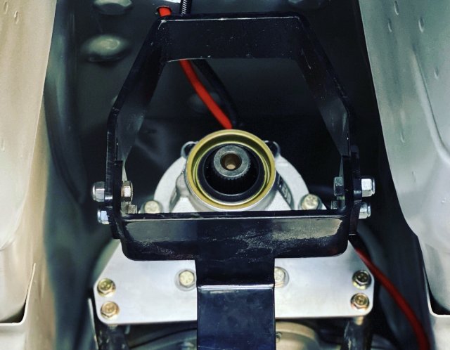

I ran a Petty's DS loop on the old car and it was a trick setup that replaced the trans cross member. I really liked it but nothing like that for the Hellcat that I know of. I'd like to put a loop on mine, what are you guys using? The good news is the exhaust will catch the DS if it breaks, but a loop is always a good idea.

I like that loop....could probably build one in an hour or 2...think I might just do that!

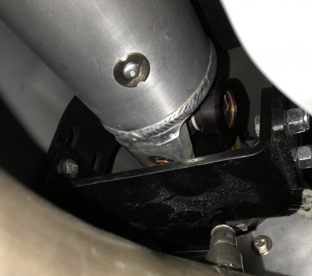

How does it bolt up? Trans cross member?
I dig the BMR but won't fit my 4" al DSS drive shaft.
Yes it just bolts to the cross member. Auto and manual versions are different due to the different cross members. I had to do some grinding on mine with the A8 due to the 4” DS but it was minor. The picture I used is with the T400 and obviously without the DS in place. There’s a lot more room with the yoke/u-joint setup I have now. EF6860F7-42E9-4E79-8C70-B6C76EE2BA2F.jpeg
I had the same DS loop on my 09. BMR makes one for the 15 & newer cars but you still use the factory crossmember.
