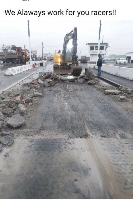

holy crap that`s a surpriseo_O looked OK on the weekend
Did you notice the cooling lines torn up.
Ronald did that almost 20yrs ago to cool the starting line on hot days.
yes I did an recall you saying about that on the weekend, they sure want repeat business, the whole family are great an make you feel important to them[thumb]

@Hpindy , @oilburner ,
If you look at the picture. It looks like the cement launch pad is getting extended down the track some. 60' maybe🤷‍♂️
So they are getting ready for me .....

The tracks website has them as open this weekend.
The cement will now extend 180' from the starting line.

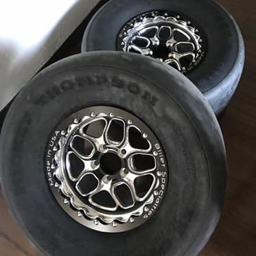

On the way home from the track my car asked me for some new shoes . Something more suited for her alcoholism .
