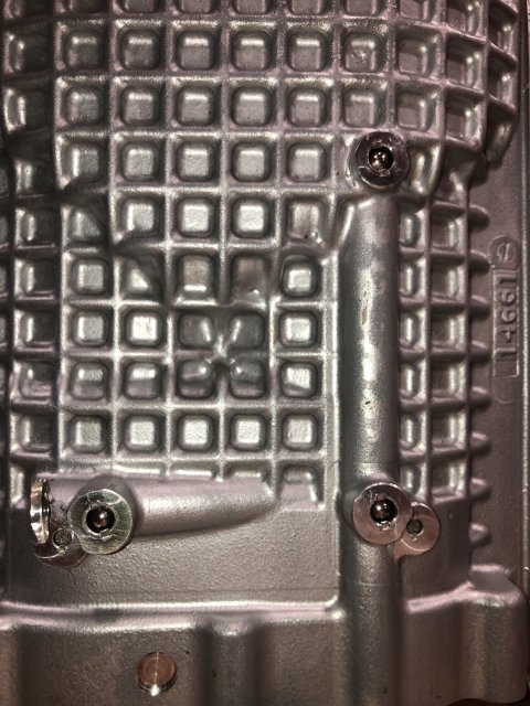

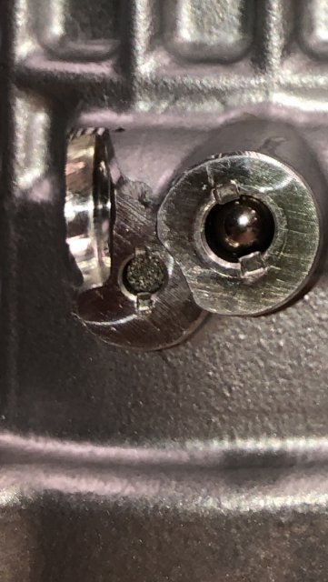

Make sure you don’t block the vent holes on the bottom.
3,823
9,055
Yes, these, their the gear case vents, not the balls the silver porous stone devices next to the seal balls.
We knew about the vents.
We cut a nice hole into the material with a hole punch so that they can breath freely.
7,609
19,943
Well I learned something
