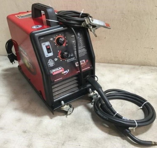

Little baby Lincolns are cheap, and easy to carry with you to wherever you need it. Don't even need a big fancy welder, but no shop is complete without one.
If its something in the bush you need to weld up, like a skidder, processor, buncher, loader or such, take the generator with you to power it.
My Honda easily powers my baby Lincoln.

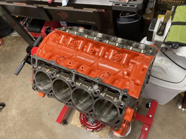

Hopefully pistons shipping tomorrow 🤞
Upon receipt then have to get assembly balanced yet :( image.jpg
3,679
8,687
Block is torque plate honed, all cylinders within .0002” of each other and all holes within .0002” in roundness, blocks cleaned, painted, oiled, and waiting :)
is that your stock block?
3,679
8,687
Yes, that’s my stock block. I only had it honed until the cylinders where perfectly round and all the same size, it’s now 4.0925”
Yes, came out the top and yes it’s the hard way but I had no other choice, I don’t have a lift like this other spoiled characters do, even worse I’m a one man band so it’s all me always.
