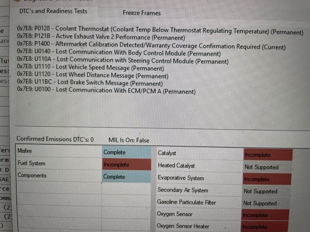

I check my dtc code with hp tuners this is what I got could this be problems with the BCM? And if so why cant you buy a bcm and they could program it with my car's vin#
