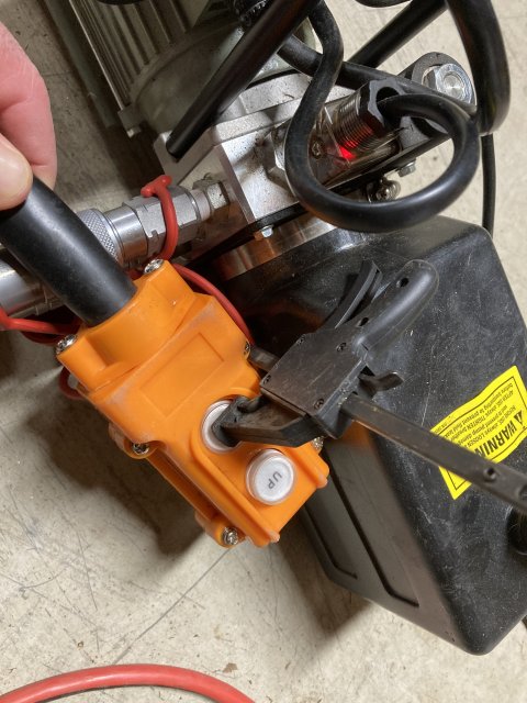

I have always had a problem with the QJ. Sometimes the connectors just don’t want to go together, apparently residual pressure in the lines from temp change. If I use the QJ on a cool day, disconnect and store the lines, then next time it is warm, there would be pressure in the lines. I damaged the seals by forcing them and had to replace 3 of the connectors.
I started unscrewing the connector to bleed off some fluid to prevent damaging the seals but that is messy and a PITA. Today I held the Down button while pushing the line connector onto the pump. It went right on!!! Apparently the line bleeds off the pressure into the pump as you snap the line on!
You guys who store your lines in a place with a stable temp may never have noticed this but my barn can see some pretty severe temp swings here in NH, even from a cool cloudy day to a hot sunny day.

An alternate way is after the lift has fully lowered, continue to hold the down button for a FULL 10 seconds or more.
I was having the same reconnecting issue and since I started doing that continued button press, I haven't had a single instance of not being able to connect them.

I always do that but that won't help when the lines develop pressure hanging on the wall. It is the change in temp and it occurs with the lines disconnected. Reconnecting is the prob.

The easiest way to fix the issue with the lines locked up because of residual pressure is to connect the main hose to the jack hose first and then hold the "Down" button on the handheld controller on the base unit when plugging in the lines, easy peasy works every time.
You hit the nail on the head when you said to hold the "Down" button when connecting to the pump! :)
The should have a option for a continuous "Down" that we could use when connecting lines.

Just hold the button in dude and count to 3 after it’s all the way down/bleeder screw open and you won’t have any issues

Thread Starter #14
My "Continuous Down" feature, makes connecting a snap!
