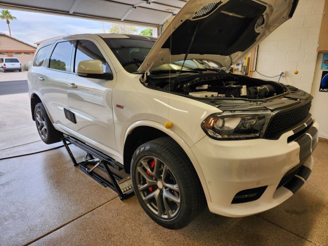

Gatz, hoping you get your Q-J quirks all straightened out soon! On a positive note, I finally conquered my fear of averting near-disaster three years ago when trying to lift the DDSRT for the first time and did a lot of thinking and research since then and faced it head on last weekend and finally devised a combination of blocks and scheme that was successful...

I should have gotten the 7k lb ones. I have the 5k lb ones. How’s your Durango holding up? I’m looking at a newer one right now (r/t tow n go)

Nice truck, correct engine:p Just got to Denver yesterday and drove mine for the first time in over a month. That right there IS my favorite vehicle for DD. They are very comfy and I can’t wait to subtract 4000’ in altitude (DA) and get it back to 980’ in MN. I don’t know if I got the balls to try it with my 5000 lb unit. @BULL treated me to his garage to change the oil and brakes last fall. Pretty sure he has the larger model. It sure has a PIA location for that oil filter.

Agree, the oil filter is a bit of a PITA to get to compared to the cars, which spoil us. My first lift attempt 3 years ago that I alluded to was with my 5,000lb unit, which I figured might get it off the ground since Q-J basically designed a 3.0 safety factor, but I never got that far - I was using ZL1 pucks on Q-J blocks at all 4 corners (bad idea) on the pinch welds and just when it got to the point of taking up all the suspension travel, the fronts started to just get off the ground, and boom - one of the front pucks got ejected, vehicle tilted, and scared the crap out of me. Luckily no damage to anything other than a bent ZL1 puck. Ever since, been nervous to try again, but I had to since it completely sucks lifting one corner at a time to get all 4 off the ground so I could at least rotate the tires. I sold the 5k unit and got the 7k unit, and even with it and my revised lifting scheme, was a bit tricky getting everything to clear the underbody rocker facia, but worked great and was rock solid this time.

They're not listed for the 'Rango but I like the Lift Pad Pros when using my Quick Jacks...

Oh, and I also use pinch-weld adapters upfront and use the built-in lift pads in the rear as well as the kit above.

Interesting, BULL. I have the truck/SUV kit above that I use for my daily S-10 with body on frame, works like a charm, easy as pie. You must be lifting further inboard to clear the fascia?
