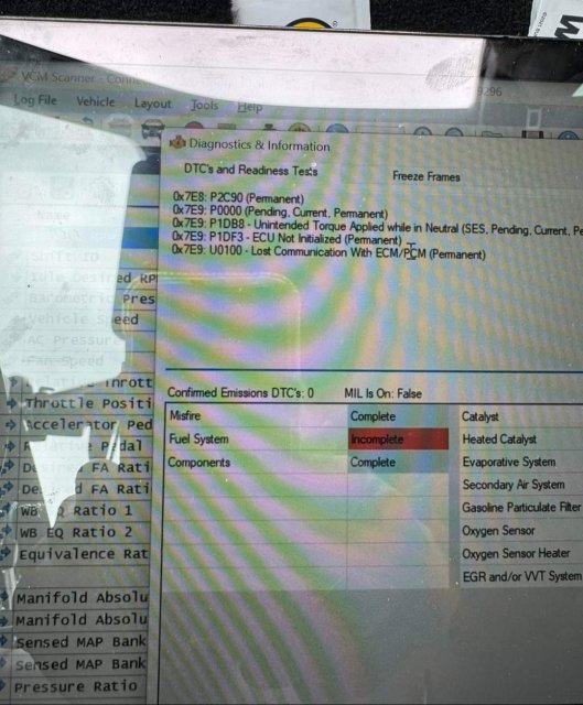

During burnout car went into limp mode and threw these codes. Will only drive in reverse won't go forward at all.

Curious why he doesn’t data log during his passes, can’t see what the car is doing under those conditions, and u fortunately a time slip and video doesn’t really help much for diagnoses. Neither do the codes unless they’re able to see a freeze frame of what other conditions were when the faults set. The dealer will take the micropod (which has built in data logging storage) and try to replicate the conditions, but I doubt they’re taking his car down the track lol
I typically data logged all my passes with my modded cars but this is a bone stock car with no tuning! I just loaded the new Beta HP tuners software on my new laptop but I was waiting on a profile from a tuner I have on see what n the past. With only a hand full of passes on an untuned car I didn’t think I was going to run into issues obviously

I hope they get to the bottom of it, understandable to not expect issues. You can data log on any car without unlocking it, regular hellcat channels should work for it I’d think with HP tuners to see what it’s doing. It’s a shame you weren’t logging, because that could have provided valuable information to dodge and the techs to hopefully find the root causes

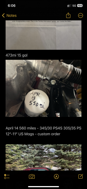

My Redeye was overfilled by a quart, too. That was another reason I changed oil early. After fully draining the pan, cooler, and replacing the filter, and pouring in the amount listed in the specs, it showed exactly at the full line on the dipstick after the restart.
I don’t remember looking at the oil level except after delivery. Carefully drove it around some streets then, my notes say …

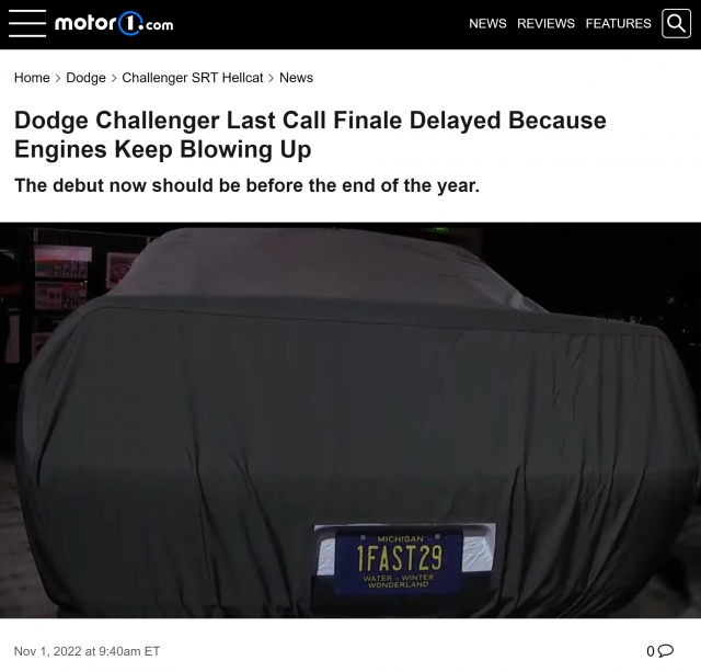

I guess Dodge really was "blowing engines." Maybe they shouldn't have fired engineers since 2021... 400 just let go this year alone!
