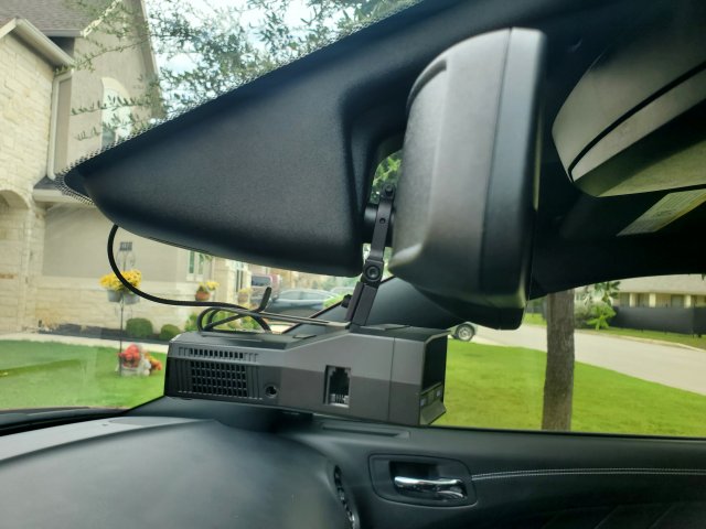

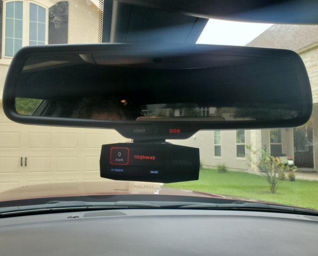

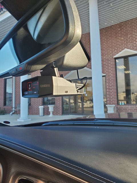

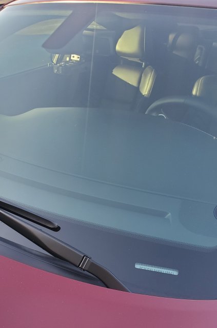

Last week I mounted a Uniden r8 with a Blendmount (BR7-200R) and a Blendmount mirror tap kit (MTX-1045). It came out pretty good me thinks.
I was concerned that it may be a distraction or have me rubber necking to see around the blind spots, it's a large detector. Luckily, after removing the additional link on the mount, it tucked up fairly tight under the mirror and doesn't cause me any blind spot grief.
It's a straight forward install but I'll share this. I had to us magnifiers to get the tap blades into the harness correctly. Tiny wires and a very small harness. On mine, it had three wires, orange with pink stripe, solid pink and black. Solid pink was hot when the ignition was on and cold with it off. Black was the ground.
It's already saved my bacon a few times. In another stroke of luck, all of the threats seem to run always on KA in my area. Haven't seen a tricky IO or laser yet.
I find the r8 extremely sensitive on real alerts. I'm seeing two mile plus notice. One thing that sets the r8 apart from others in it's class is the ability to detect very short bursts of radar which should help with those pesky troopers nailing people with instant on, but I haven't been able to test this claim yet.
What is your set-up? Preferred brand, model, mounting and power source? Throw a pic up if you are so inclined. :)

Looks clean, I've not seen an R8 in person & had no idea they were that large !

Thanks! I'm happy with it. It's a big mama but looks decent in a big car I guess lol... It does look larger in the pics I believe.

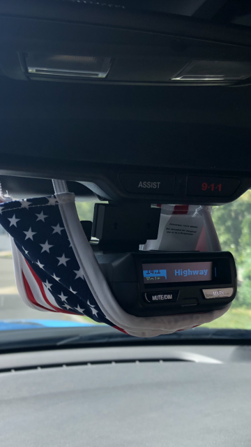

Ive got to look a bit closer at my Uniden R3 with BlendMount set up. Maybe I can loose that link as well but I still need to fit my finger between the unit and mirror to access the top buttons. Hate screwing with it though as the wiretap into the mirror was a delicate pita.

^^^ 1st good use for a face mask (now detector mask) I've seen yet !!

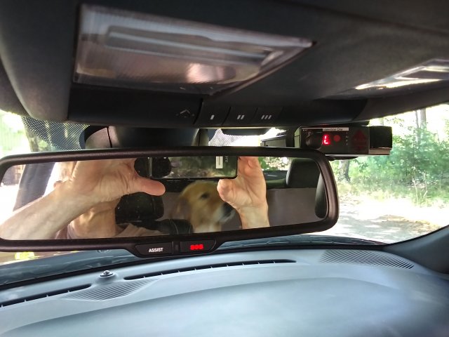

Also, I do not like things blocking my vision, I even hate poorly placed inspection stickers. I like my RD tucked up tight above and to the right of the mirror. Also, better not to advertise. 20220907_123555_HDR[1].jpg
