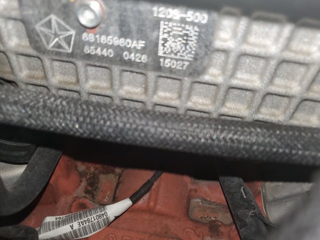

Got the car home today and grabbed a mirror to look at the plaque on the back of the supercharger. Mine ends in AF.

I agree, it doesn't sound terrible to me but it did have an audible change on cold start one morning, enough to where I started my car and thought "what is that?". Now, I cannot un-hear it! When I listen to the comparison videos though, it seems clear to me that mine is probably starting to go bad.
Just looking for some reassurance either way. Maybe Dodge knows that 95% of the blowers with the AF part number had bad bearings or maybe not a single one of the bad blowers was an AF part number. Maybe they can tell me which dealer in the city to actually take it to, someone well versed in the issue.
