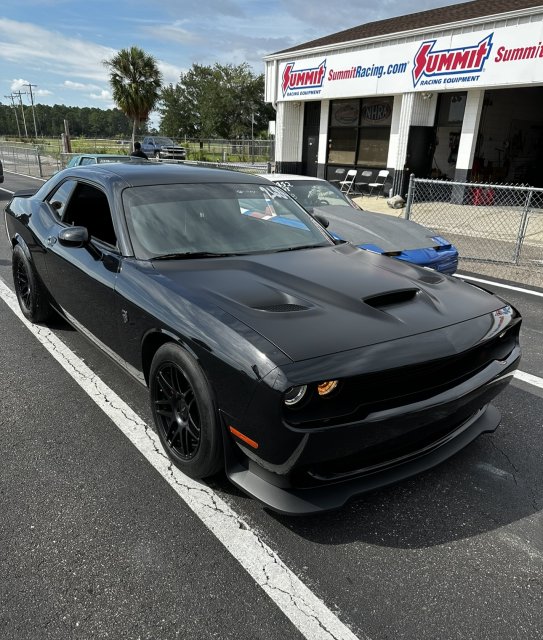

You know how hard it is to photograph phantom black ha

Yep, looks black at night but sparkles greens and blues in sunlight
Is that the color with the metal flake?
5,498
4,529
Always get compliments on it
5,498
4,529
I wrapped my roof and trunk myself to match the factor painted satin hood. Also got a factory satin black shark fin antenna that they use on the T/As

Looks great like that. Phantom Black really is a great color on these. Looks like Pitch Black until it’s in direct sunlight. Then it absolutely pops.

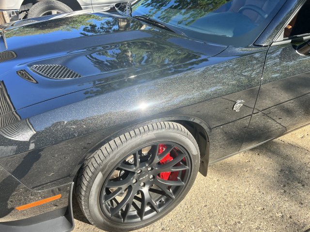

Thanks man
5,498
4,529
It’s a 3 step paint job. Expensive to get anything painted that color
