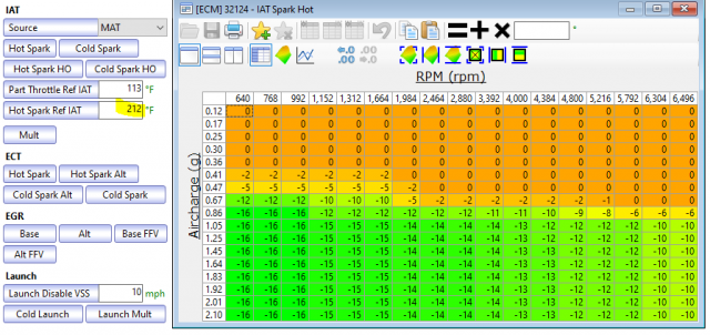

Dodge is coming out with a revised calibration for the D170. There is an issue with the engine derating when the supercharger gets overheated. So in hot weather making multiple passes the engine will derate. So, as it is now, the low MPH could be attributed to this going on. I have coached a couple of people that were clearly experiencing this.
I have never had this issue but I try and cool my motor down as much and as often as possible without using ice.
On the 500 mile issue. They give you the trans brake etc. at 500 miles. It clearly states for track use only. Simple, no? Plus when he was trying to get me to run that Lucid in the Hagerty Video, Tim Kuniskis wanted to make sure I wcould have the 500 miles before showing up to shoot the Video. He specifically asked me that.
Interesting on the calibration change. The only thing I've seen on mine is it starts to pull timing as IAT increases which lines up with how my Hellcat functioned. There's a table for that. The most I've seen on the 170 is 2° when IAT is above 150°. It didn't seem to slow my car down though. Like you I try not to hot lap the car unless I'm forced to in competition so maybe something else happens at higher IATs?
Here's the table. You can see the reference point is 212°F for IAT so the closer it gets to that number the closer the timing pull gets to the max in the table. IMO if you get to 212° you've done something wrong.

Is it really iat or MAT though. Also, when you’re at 170 MAT you’re not really at 170 in the cylinders due to e85
7,271
18,973
If you look at the image I posted, it shows IAT is measured by MAT so technically both I guess lol.
