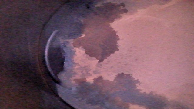

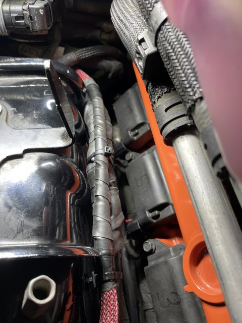

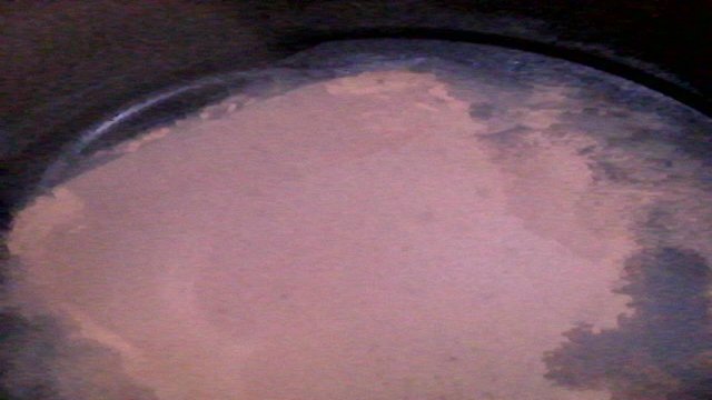

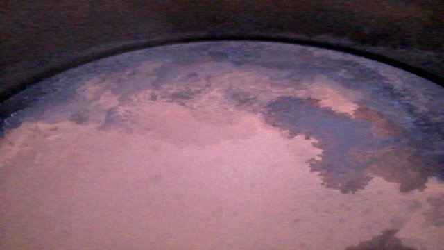

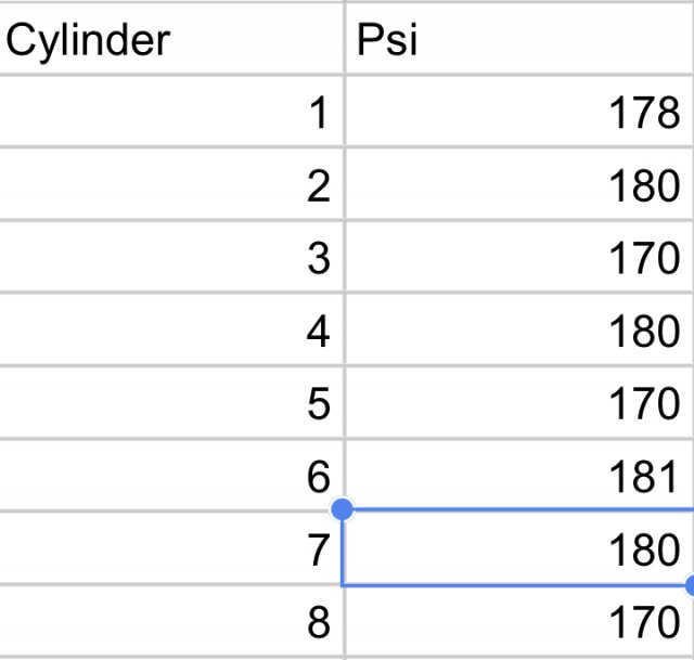

7F95CB63-938A-4208-B6BE-947437925CDE.jpeg AFF3C892-D639-4A99-A319-3E0E338F76B3.jpeg ACED9A47-A1F7-41FE-A70F-F930F952B6F7.jpeg 6A71536D-54FE-42F2-8205-513D42588180.jpeg 147BAD54-2A27-4FF6-810A-4C4B64A30808.jpeg 045A1D46-2B8B-4236-99E8-94807B620225.jpeg 3EE22825-9E41-47F1-B627-4B56F9BA7007.jpeg

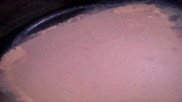

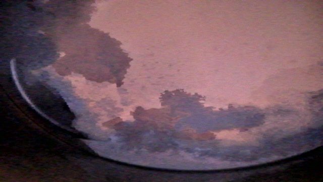

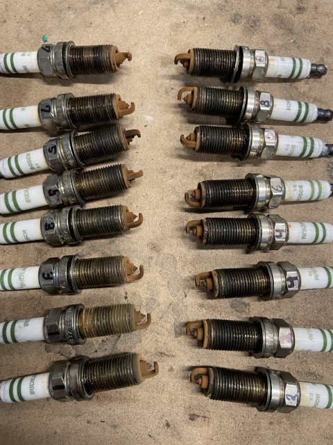

All cylinders on the left side are healthy. @Speedy! and I were worried about #7. Other than boostane being found, all is good. Time for more boost! Also have new knock sensors just in case.
obligatory puppers post
Nice, minimal if any real carbon deposits.
How many miles on this motor?
4,129
10,396
Thread Starter #51
sixty thousand, and sixty thousand more to go!

So after evaluating the data, the knock is not coming from the cylinders. On first drive it was smooth. Still going to replace the knock sensors but I’m glad plugs are done.

e85 should clean that right up:)
