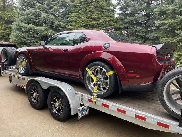

How are some of you guys tying down your cars? I plan on towing mine occasionally this year which means I need to invest in something to secure it to my 18' open car trailer. I've towed alot of stuff over the last 30 some years but nothing this low or expensive. The ratchet straps and slings I have are ok for trucks, tractors, and rescuing my childrens vehicles, so what i buy will be specifically for this car.

Vulcan straps- all four corners and no worries.
30,144
133,034
I X strap mine through the wheels since it's below the suspension. It stays tight 99% of the time, even through South Carolina on I95 north.

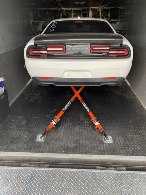

I cross them in the rear and the fronts i have straps that go through the front wheels, I use Vulcan straps and have been very happy with them. I currently do not have a picture showing the front, attached is the rear. View attachment 94531

I already had the straps with hooks for my open trailer and it does not take as long to unhook them versus undoing the strap from the ratchet portion. My car sits to low in the front and I am too fat to squeeze between the trailer and fender to try and hook the hook under the car in the front, lol
So far I have never had the straps come loose, doing it like this. My normal drive to the track is 3.5hrs or more.
I'm rolling around on the floor and sweating my old, fat ass off but it sure keeps it locked down.

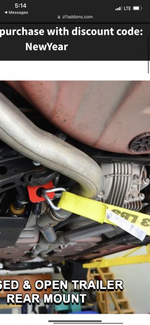

I cross them in the rear and the fronts i have straps that go through the front wheels, I use Vulcan straps and have been very happy with them. I currently do not have a picture showing the front, attached is the rear. View attachment 94531 https://zl1addons.com/collections/dodge-challenger-accessories/products/challenger-strap-points
What I am using for the rear points.
What are you hooking to on the car?
I use that red tie down piece from ZL1 Addons
I looked at them. Definitely easier but I don't trust any attachments above the suspension. It has a tendency to work loose?
