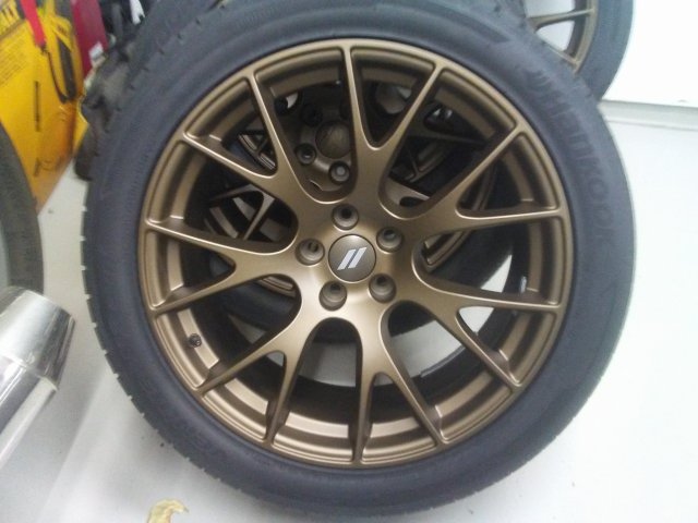

I'm looking for some assistance in changing my stock wheels to a reverse rim either cast or forged; 1 or two piece or anything that will fit without the use of spacers. The current specs for my 2013 dodge Challenger SXT Plus, Sport Mode, with 3.07 rear axle ratio and 245/45-20 tires 20 x 8). I would move to a 20 x 8.5 also. Dodge Challenger - 1.JPG The technical specs list the fitment as:
Center Bore / Hub Bore: 71.6 mm
Bolt Pattern (PCD): 5x115 (Pitch Circle Diameter)
Wheel Fasteners: Lug nuts
Thread Size: M14 x 1.5
Wheel Tightening Torque: 176 Nm
Offset Front: 17 to 26 mm.
Offset Rear: 15 to 25mm.
Backspace- 5.44488
Offset +24
Center Bore: 71.5° 'Critical'

Not sure on any of that, my 2021 SXT has 20X9.5 repop AE Hellcat wheels and the fit just fine.

Stock wheels were 18 X 7.5 and looked like crap. I like how the brass monkeys look on my Hellcat, so put them on the V6 car. I stopped there though, no Hellcat badges or anything else on the V6. I've no desire to be that guy haha.

Found some center caps painted in smoke show to match the color of the car. I don't usually deviate much from factory, but I really like how they look on the car.
