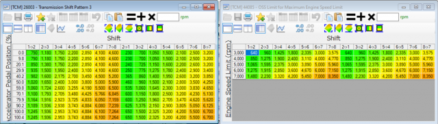

You too have the 1-2 shift at 1500. It seems like it only hits 79.9 percent in the 1-2 shift. Anything above that is irrelevant.
Thanks for pointing that out. I generally lock out 1st gear at the track and must have not set that shift back correctly. That explains blowing throught the 1>2 last track outing :eek:
It was supposed to be 1400. Correcting now

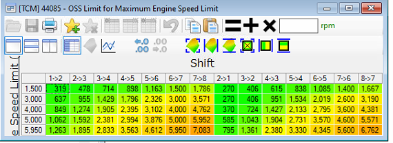

@fumanchu182 So taking time on the car today. I looked at the max engine table. Can you show me your math on that? This is what I convert it to. With this being the case this table is a limiting factor
Output shaft speed
Engine speed
Output shaft speed
Engine speed
Everything is based off output shaft speed.
8hp90 gear ratios are
1st-4.71
2nd-3.14
3rd-2.10
4th-1.67
5th-1.29
6th-1.00
7th-0.84
8th-0.67
I personally dont like high rpm shifts into overdrive so I only adjust 1st-6th
commanding a 6200rpm shift would be
1st 6200/4.71=1316.348 so OOS would be 1316.35rpm for 1>2 shift
2nd 6200/3.14=1975.522 commanded shift point would be 1974 for 2>3
3rd 6200/2.10=2952.380 commanded shift would be 2952 for 3>4
continue for the rest of the gears
Output shaft speed
Engine speed
When I look at my Max Engine Table (44085) it is not limiting my shifts at all:
How is the Max Engine limiting your shifts or what evidence from a log do you propose supports this? When you hit a redline or blow past it and put the car into a safe mode, HP Tuners will tell you when you log it?
Ok now this is getting fun. Your values are much higher than mine stock. I just checked @vortecd stock read from his 2016 and it matches yours. Look at mine below
Also I have never had any shift issues. So I haven't logged for it. Above I said i've seen a few people at the track have issues especially after the burn out and I wondered if this table was the reason.
