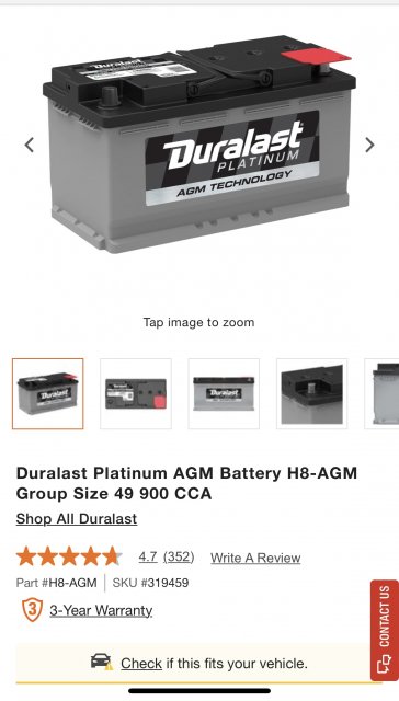

Thread Starter #19
I’ve read good things here about this one:
