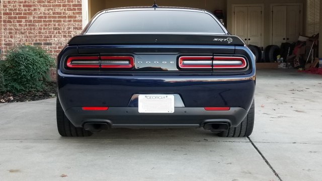

I’m running a 315 tire in the rear on a 11 inch replica with no issues on my Challenger! It looks badass with that staggered look.315/35/20 traction is awesome. View attachment 8917 View attachment 8918 View attachment 8919 View attachment 8920 View attachment 8921 View attachment 8922 View attachment 8923 View attachment 8924

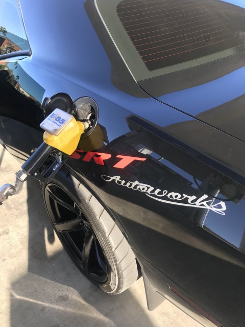

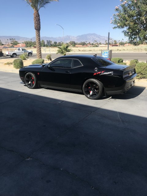

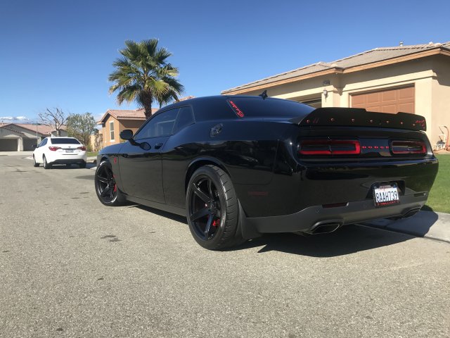

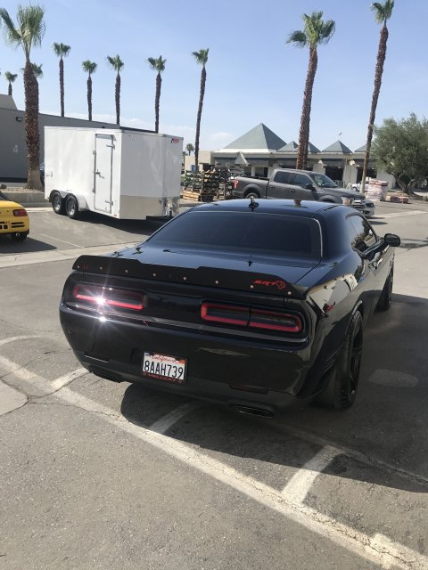

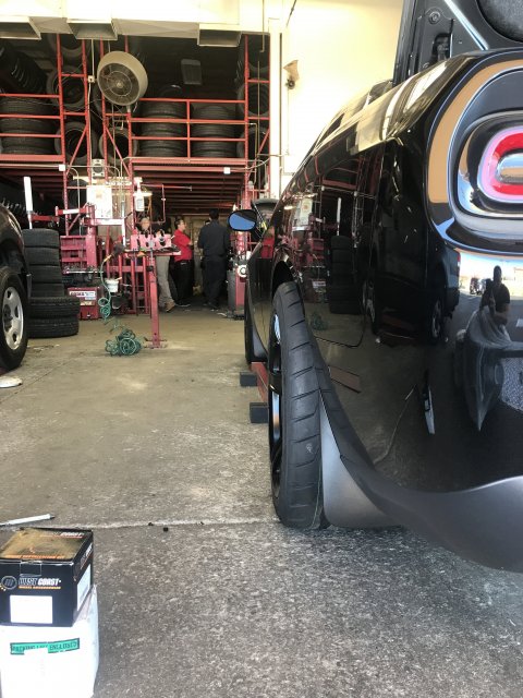

Here's a 335 on the rear
And a comparison of a stock 275/40, a 305/35, and a 335/30.

What is the rim width and offset that gets that 335 in there. I know you have the Philips flares, but they're not rubbing on the inside? or hitting the quarter panel rear wheelwell lip? I love a fat ass and those 335's look like Jaylo wear'n a thong and lettin' the fat show. LOL

I don't know the offset but the rim width is 20x11.5". I had Paul at PK Auto Design build them, I just told him how much extra space the flares added to the width of the car and he did the math. And, they're not rubbing on the inside or hitting the quarter panel lip.
