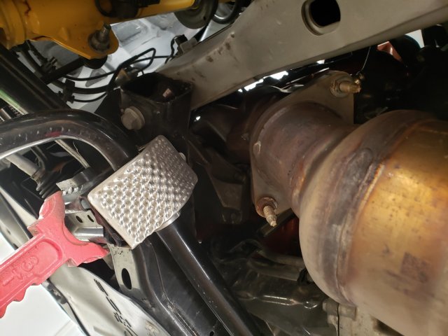

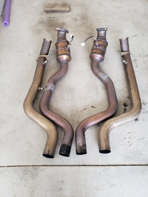

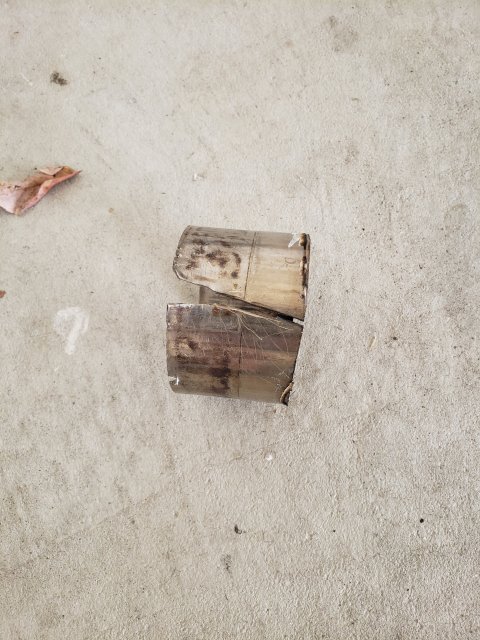

So I have the stainless works cat-deletes that I had used on my Daytona. I'm also using vibrant 02 spacers which take the after cat 02 sensor and move it out of the stream so you don't get a CEL. Worked fine on the Daytona but I have heard some Hellcats have throw the CEL even using a spacer. The reducers I had to cut to get them back off when I removed the stock exhaust and installed the 3" Hooker Blackheart system on the Daytona. I needed to use the reducers (3"- 2 3/4") to put this back on using the stock exhaust. I had cut a slit into them to remove them (the reducers were stuck on the cat deletes) so I just shorted the reducers after where I had cut them so I could reuse them. The reducers are about 5" long. Maybe I should have shortened the end that went into the stock exhaust because it didn't want to go in very far. I even smeared anti seize all over them. After getting ever thing bolted up they were leaking at the exhaust manifold. Not real bad but you could part your hand near it and feel it. I got the driver side pretty good but fought the passenger side. I have some high temp silicone but decided not to use it. It was start the car crawl under find leak crawl back out shut the car off. This happened too many times. Funny thing is I did not have this issue with the Daytona.

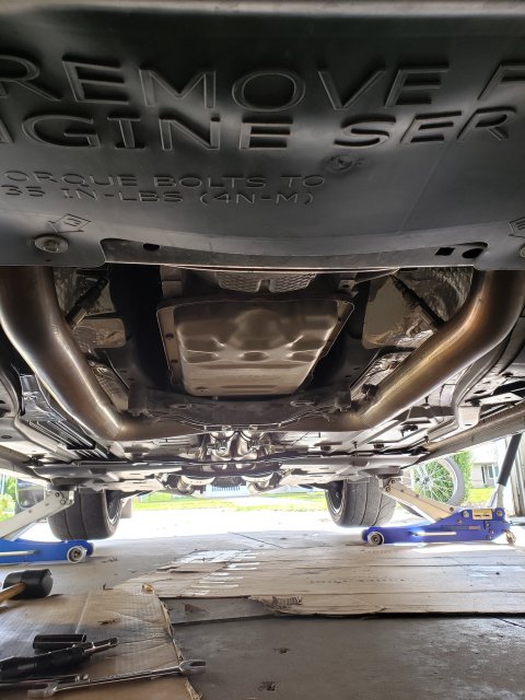

Where are your jack stands
agreed...would never get under that...yikes...

I had to jack the rear up to get the cross brace off so I could try to knock the exhaust in better using the metal bar that holds the exhaust apart. I could get back to it I jacked it up for a little more room. The front was up pretty high. The jack stands are under engine cradle
