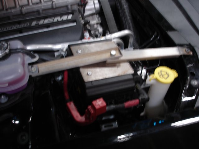

Why would that matter? They don’t even need to bring a relay, just pull the one next to it like high beams and put in its spot. Starter relay also just needs a jump between 2 spots for a second, no need for a relay. They all know this and to reconnect the red wires at the pts.
I engineered a version of "kill switch", but was aware of the above was possible. So that was the reason I armored the TIPM. They would have to spend some time forcing their way into it. It ain't pretty, but it may discourage them. I later added a padlock in addition to the TORX security bolt shown.

That will only add a minute to their time and does nothing to actually stop them from deleting snd making a key, starting it and driving away. Adding IGLA is a far better option and you can literally leave the tipm cover off and its still not starting/driving
