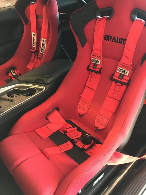

Can’t believe this thing is going on two years now. My belts expired! NHRA tech requires current SFI Certs on certain things and the belts are one of them. Time to change it up a little!! C843237D-B183-41A2-A86F-73E70EF6B736.jpeg F94752D9-DCB0-4319-90D2-7B7A9DCA0995.jpeg

Black belts with red stitching and some custom embroidery that says stink eye or SRT Autoworks on them!👍

I know! A bunch of NHRA/SFI money making BS. The belts I’m throwing away are like new. 😡
Sorry but those red belts are the new ones. I went with the 3” with the dog bone shoulders to accommodate my Hans.

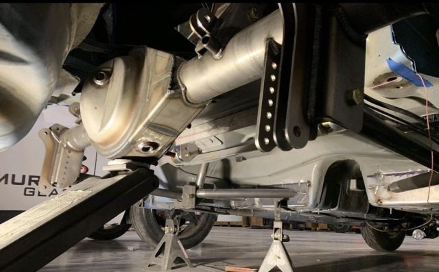

Not much going on with mine at the moment so.... I’ll talk about something we’re doing that has me excited for next year. If you look at that 8.90 video, you see the red widebody that I’m running with. That is Joe Padilla. He is from SoCal and is another of the SRT Autoworks cars. That thing is a monster in the making! He is going into Carlin Fabrication in SoCal next month for a full 7.5 cert cage, chute and....... the MPR Drag Pak rear end. I have been helping to orchestrate this and with what I’m learning, and the wheels that are now set in motion...... I have little doubt that I’ll be doing the same thing in the future. This all started when I was contacted by another Utah based Hellcat owner (B5redeye) who heard about my car and is in the process of building a full-on outlaw HC. He opened the door to MPR for me and now we’re off and running with that. MPR supplies the suspension and chassis stuff for the NHRA Factory Stock Class builds including the Dodge Drag Paks, COPO Camaros and Cobra Jet Mustangs. Here are some preliminary pictures of what I’m talking about. Besides shaving at least 200 lbs of weight out of the car.... these 4-link setups plant the tires like no IRS can ever do. 8D08ABE5-4089-4263-8A9E-E48583CBEFB5.jpeg 4FBB60F2-3144-42A6-8179-EDA760897AB8.jpeg CC4DCF9D-BB8C-4BE9-AF62-6161BFB577DE.jpeg 957BA229-0024-4F52-981E-43A035DDDD40.jpeg 5E311758-3377-41F3-949D-CD37661705DA.jpeg 5F9778CB-DD69-4085-A61D-4495EF66F43A.jpeg

Nice!! That car is already stupid fast. You talk him into a TH400?
