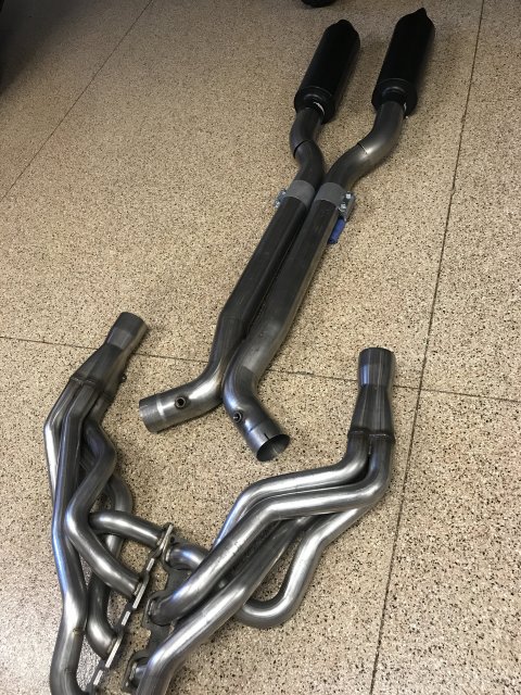

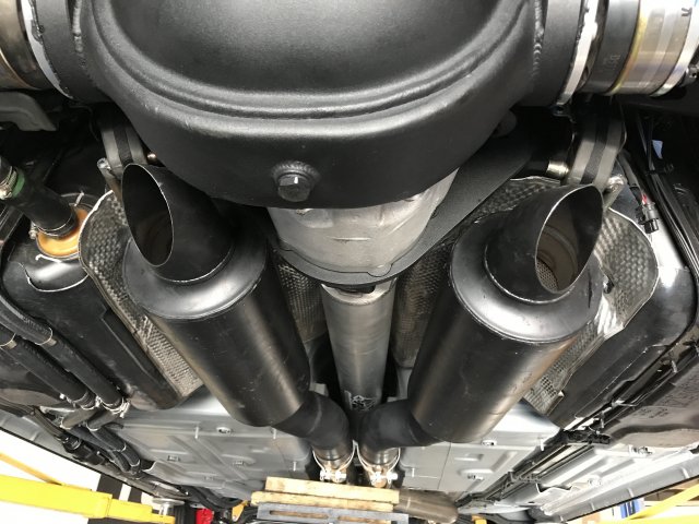

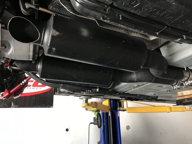

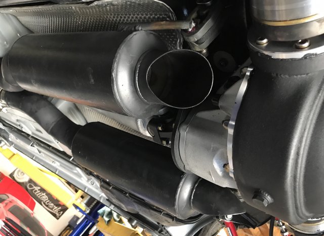

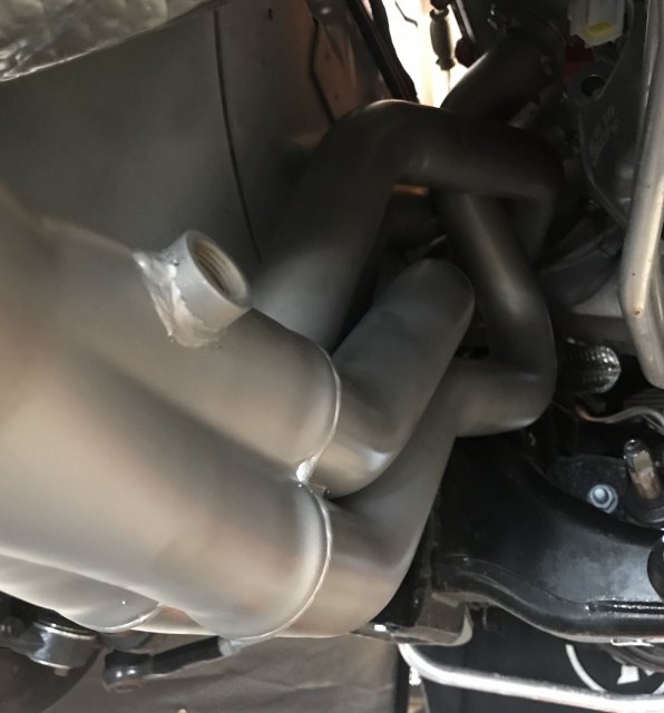

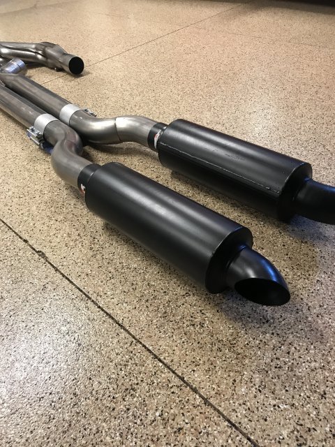

I’ve have some people asking about my choice for the exhaust system on this build. At this time, the largest pre-built system available is the 2x3.5 inch race version by ARH (American Racing Headers). The equal length primary pipes go into a merge collector that opens up to 3.5 inches. That system is available in a full headers to tail pipes combination. But..... I decided not to use that and went with a set of 3.5 inch in and out race mufflers instead of the 3 inch mid muffs and resonators that come with that full system. The mufflers I went with are Flow Master 6”x16” straight through race models. They call them “Laminar flow”. There are no chambers in these like most Flow Masters. I spent days reading everything I could find on mufflers trying to sort through the advertising hype. While needing big flow capabilities, I want it to be subdued under normal around town street use. As it turns out I think I hit my goal. They are surprisingly quiet at idle but still have a deep rumble that sounds good with the cam. At WOT they can be loud as hell as long as they’re civilized on the street. On the back side of the mufflers, I went with turn-downs that are aimed at the ground just behind the rear tires. This does two things.... in the event of a engine failure it’s not going to be blowing oil in front of the rear tires, and two.... on the burnout, the exhaust blows the smoke out to the sides. Looks like a smoke explosion! 😎 This required some custom tube fabrication to place the mufflers but we managed to do that in house and are happy with the results. One other thing I had done was a “titanium” ceramic coating (inside and out) of the headers. The goal being reduced under hood temps. Here are some pics..... 86BE30DB-071D-499F-BBFE-E7BC6BD69926.jpeg A8985166-6AE3-4A86-9F3D-018B899F4E59.jpeg C62C869E-60AD-425B-96FE-94D1932FCE7F.jpeg C9B8A61B-9D85-4F0B-A4A9-DF601023B8F1.jpeg EB8BE68A-825B-4D13-9EC5-54CB21FBBF33.jpeg 45DFA1BA-5DE8-40E1-AFD1-C78923C791BB.jpeg 08BE8C17-F76E-46D8-A42B-090626F62203.jpeg
20,157
Nice. except for the titanium header coating (mine is lowly ceramic) that's very similar to the exhaust on my SC GTO
11,025
I bet that is Sunday church quiet ...
20,157
Mine is not super loud, really great sound at idle and under 1/2 throttle or less. Get it on and the world knows about it.

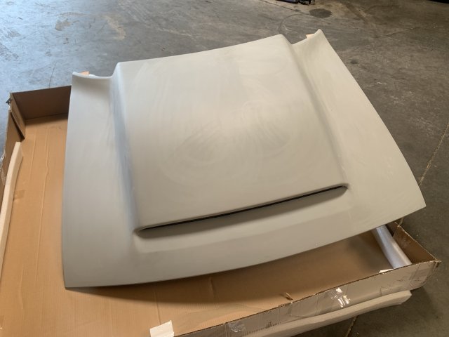

It is amazingly quiet at idle. I have a feeling that at WOT it will be a different story but that’s going to wait a little while until we get on the dyno. Other than tuning the only stuff left to do is get the rear tires mounted and on the car to check fit and get the new hood on. That came in and is being wrapped today. D50DDCFB-D107-4144-9725-D5CB83714F61.jpeg

Is that hood made in China? Inquiring minds want to know.
Lol... No! It's made in California (which is rapidly becoming China) for Kenne Bell.

It is amazingly quiet at idle. I have a feeling that at WOT it will be a different story but that’s going to wait a little while until we get on the dyno. Other than tuning the only stuff left to do is get the rear tires mounted and on the car to check fit and get the new hood on. That came in and is being wrapped today. View attachment 1652
Fiberglass?
