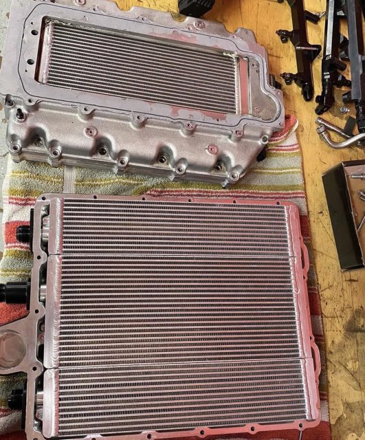

Holy crap . Just by the pics if the whipple lis 4,5L then then other one looks like a 10.0L! Lol
I know you would think that. All that size is intercooler. It has a huge double pass IC on top to handle the 30 lb boost potential.

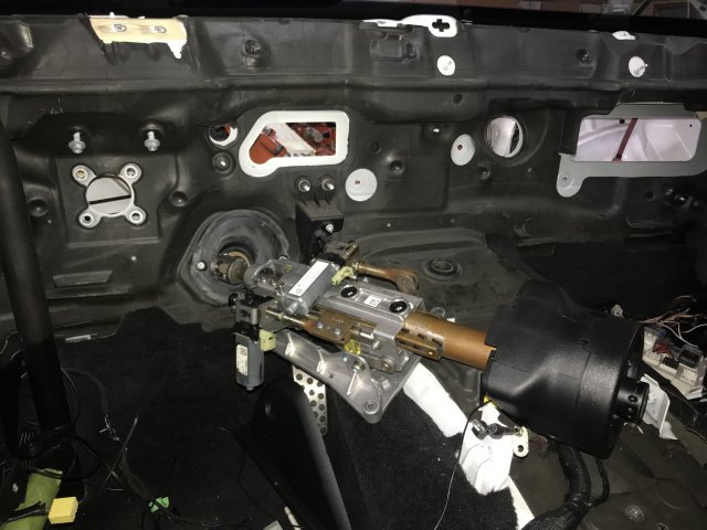

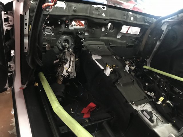

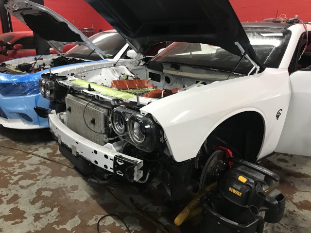

I hate this part 😖 0F081B11-F5CB-4E98-B1D4-10182825BCA5.jpeg BB812D47-AADE-4E08-988A-FFA5C7B9572E.jpeg 215FC905-0859-4B5B-A3A9-2D94E5AEA287.jpeg E47C4495-74EC-4E06-8A35-B3DBA490134D.jpeg

What part don’t you like? The heart transplant into the Charger? Some would consider that an upgrade. Haha.

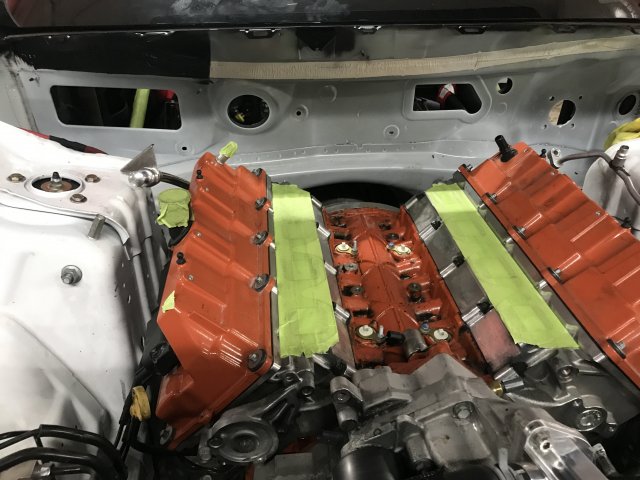

i just noticed the oil intake is on the left side… am I hallucinating?
The 4.5L needs the intake removed for oil changes if you don't swap valve covers. Not sure if it's still the same.
It just makes it more convenient for oil changes to swap the valve covers like that on big Whipple and KB cars.
That Charger is getting my 4.5 Whipple. It’s already got a 426 with Thiteks in it so she’ll be stout!

From what I have read our cars have 1000 lbs of safety and convenience over a drag pack .
There’s a lot of “convenience” in there. Look at that contraption surrounding the steering shaft!
11,025
Airbags, speakers, wiring, insulation,trim, etc Through out the whole car adds up after awhile...

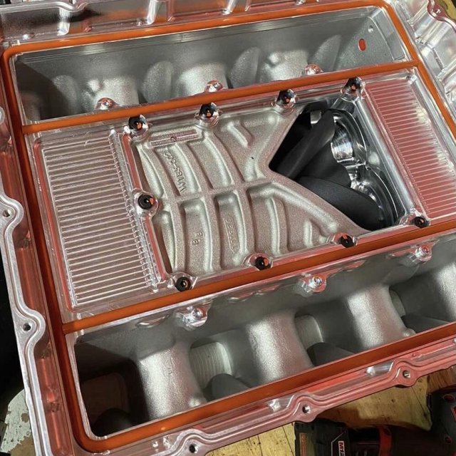

Who’s ever seen the inside of a 3.0 Dragpak Supercharger? The answer to that would be…. Just about nobody. Here you go.. 🤓 BFAB8815-A60A-4306-9020-50F5B74BA5BE.jpeg 4E70ED4E-1705-4A0D-A496-5210D4CDEEAA.jpeg 0AD0052E-B7ED-472A-94BC-CA8EE3C1149B.jpeg 4255F674-4E89-4DE0-9FCC-301B55813ED8.jpeg
3,633
11,720
Thread Starter #879
Can you say holy intercooler!!!! Check the comparison to the old 4.5 Whipple sitting beside the new DragPak. That’s why the external dimensions are so huge.
