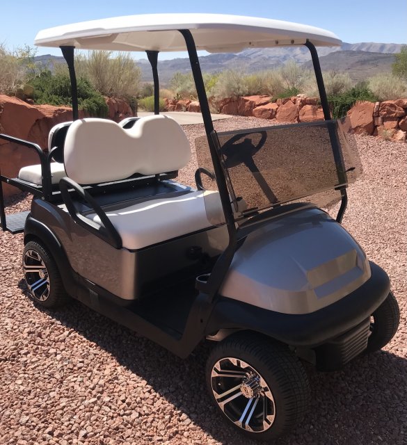

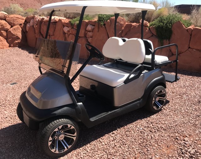

New addition to the race team. Easier to find pit crew volunteers when you got one of these. ๐Ÿ˜Ž EEB87C72-4342-428D-A872-012888F6B366.jpeg F3673263-A3D2-44D4-83D3-87B91107877C.jpeg DB35C036-FA5E-42DE-9B31-8010A6B302E2.jpeg

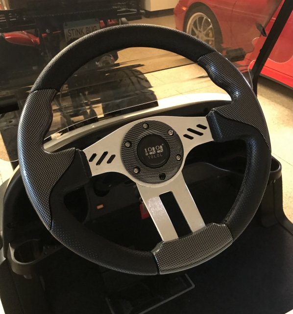

Jeez. Keep your pants on. Lol I just got the thing 4 hours ago. I did have to get the ugly steering wheel off and upgraded. I got some fun stuff in boxes waiting. E5E17A60-2967-49AC-A1E6-0A5334875EB8.jpeg

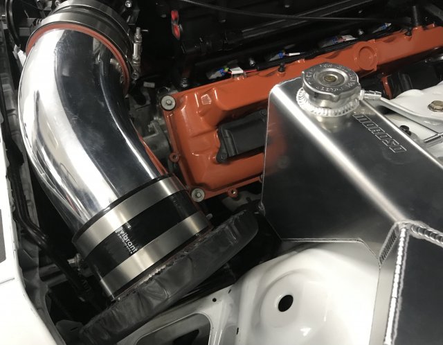

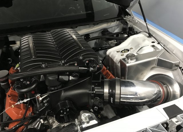

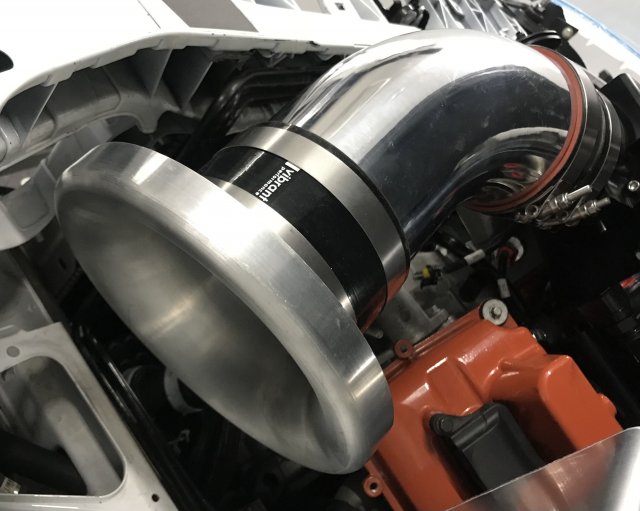

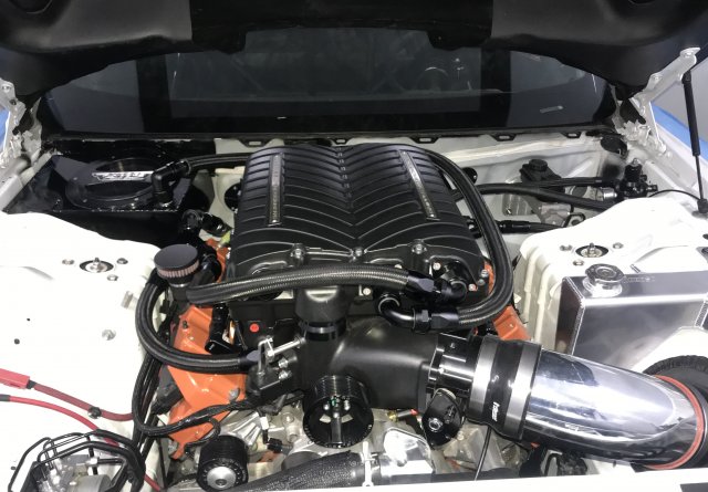

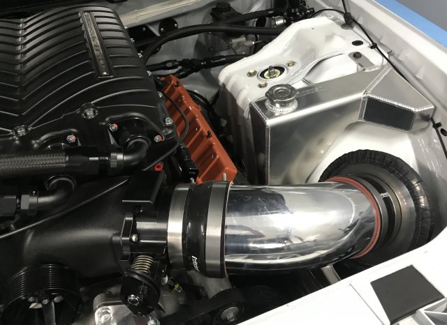

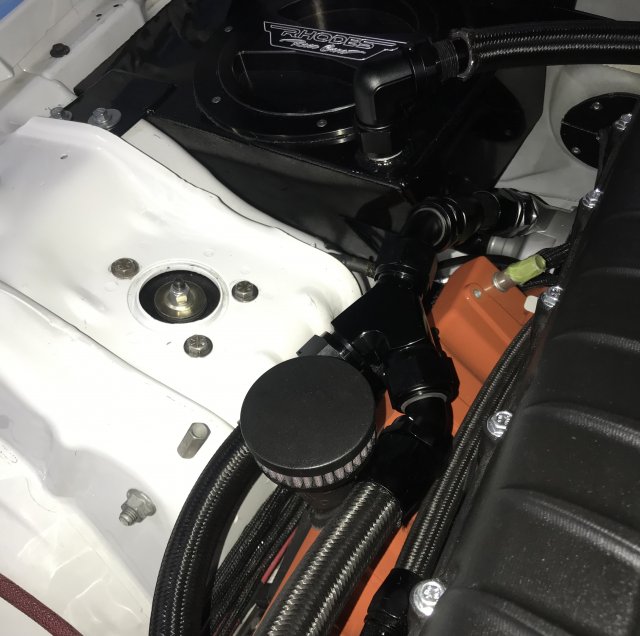

No nitrous! Just lots of air!! FBBF9CAE-B446-469B-BCFA-E288CCFC8D38.jpeg 9412D082-61CB-40C9-A9B2-11820328B100.jpeg DD5CFBAD-F9E2-4BA6-84F4-CC365C9353ED.jpeg E28249D5-4BF9-497C-94F1-242ADEB54DDB.jpeg 2E4B7C7C-977D-46D8-A437-E52A7AB8EBC8.jpeg E24BB1EE-B932-4C05-B513-44007AE5A713.jpeg

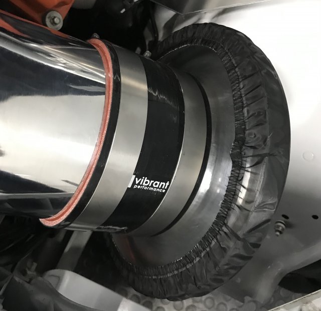

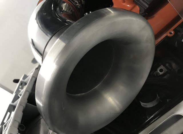

No. Thatโ€™s their problem ๐Ÿ˜‚. You will note that there is one of the mesh filters on there in some of the pics. Thatโ€™s there for all engine running time up to on the track. When itโ€™s time to run, that will come off and birds and small mammals be damned ๐Ÿ‘น

Every time Iโ€™ve thrown a belt or snap a tensioner, pieces of it get everywhere in my engine bay including my filter. On top of that, my mph never really changed when I tried no filter on and off for most of last year so I run with one now all the time. Just something to consider. Your risk of throwing belts is probably a lot lower then mine given the rotor mass is considerably less in that 3.0L
That is certainly a consideration. Just looking at the belt placement and the probable stress on the tensioner with this 3.0 compared to the 4.5 is hopeful as far as the life of the belt goes. I knocked the belt on my 4.5 off a couple of times but never disintegrated one. I know the Dragpaks donโ€™t run a filter and have a forward facing open Ram air setup. I canโ€™t do that with the stock cradle and radiator in my car. I am thinking about how to fabricate a box around this to separate the intake opening from the engine compartment. Not a tight airbox, but something that will create some containment for the air coming in from the headlight opening and also the heat exchanger opening below. I also have a K&N type filter that attaches in place of the velocity stack. I am planning on doing a comparison between the two once Iโ€™m on track. I wonโ€™t be surprised if it performs better with the filter and if it does then weโ€™ll know. If notโ€ฆ. Wonโ€™t I be smart! ๐Ÿ˜œ

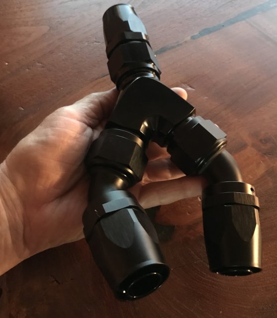

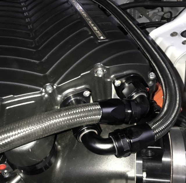

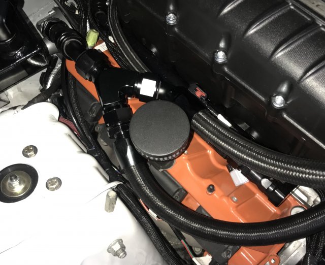

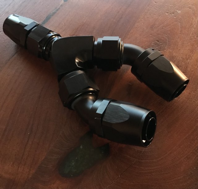

No halfass intercooler hose fittings for Stinky. Off the icebox coolant line splits for dual entry into the DragPak Whipple. Look at the size of this guy! AN-16 Porn star ๐Ÿคฉ 7912413A-EFCA-4157-AE85-8C1748155216.jpeg 91E7A442-E199-4184-BB7D-84F6E7E0E159.jpeg

Quick release fittings?? PVC sch 20, 40, 60??? Very nice just would like to know the schedule of wall thickness.
Haha. No
6,293
I didn't think so. Under those conditions,, you do not need the weakness. Have used them under low pressure. Thought that wood get your attention. Man U Well Breaka Way. Fittings. No wall thickness?? That's alright. I can dial it in at the high performance shop when they bring me a sample.

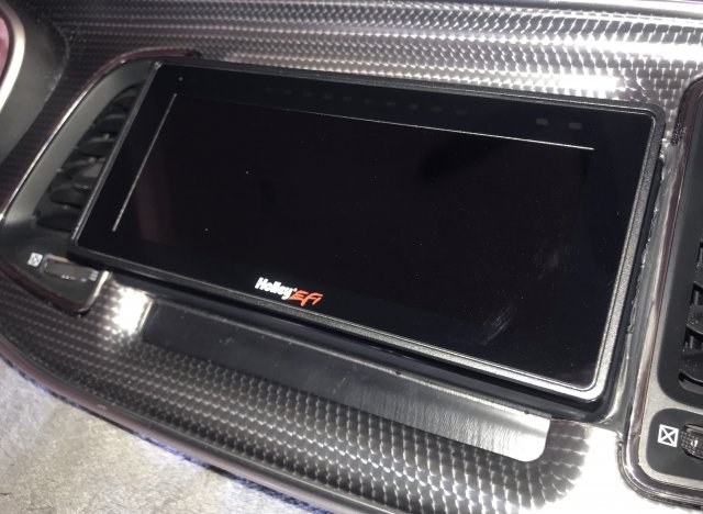

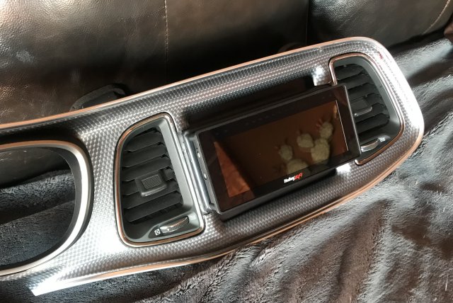

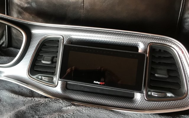

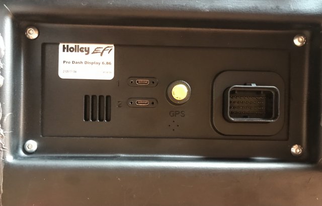

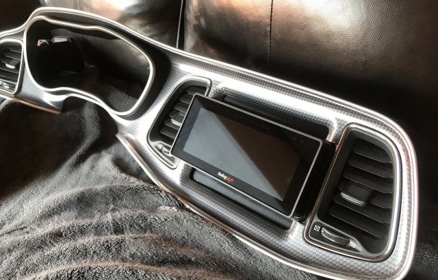

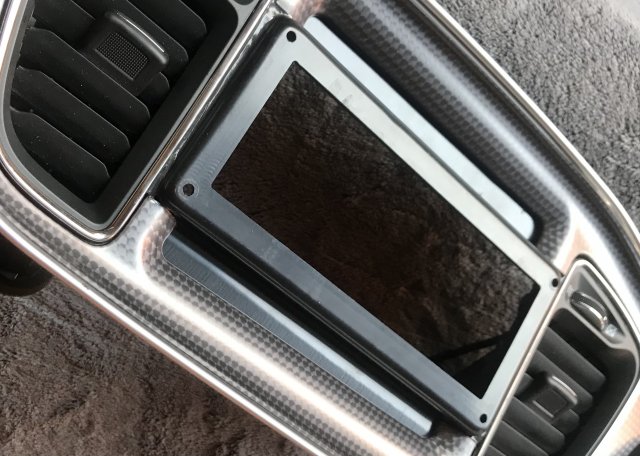

This was a big one. Iโ€™m keeping the stock dash in the car and needed to figure out a way to mount the Holley Digital display screen. This took some modification/fabrication/figuring to get it done, but it turned out clean and solid and within easy reach for the touch screen functions. D0CCE1F7-5083-4C46-BCFA-B40A91212610.jpeg 8049C0B4-8BDF-4462-87FA-328F41745E6E.jpeg F36313BF-7342-435A-94F5-39D70892234A.jpeg E56DC497-07E8-407D-B3AE-E652587348CD.jpeg 2EF62363-5FC2-434F-9230-FD57415AA06D.jpeg 588493EC-867D-4042-B6EB-2172E0FF48EF.jpeg
