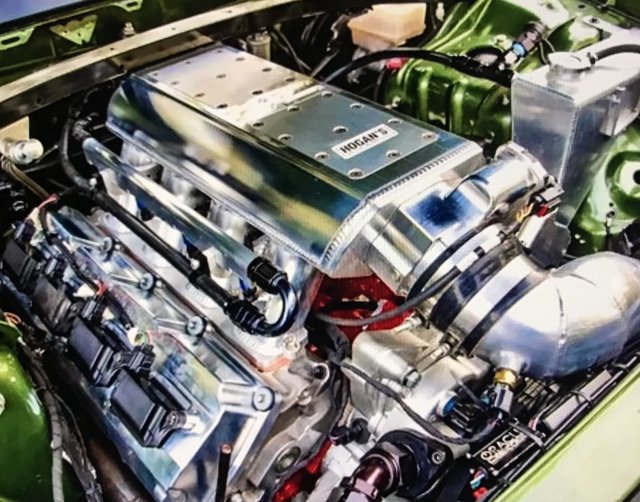

Combination of stuff coming together. I’ve been friends with James Golden for years now (ever since I loaned him a Whipple pulley at a MSHS race in Kentucky 4 years ago). He’s been trying to talk me into going turbos and after he stepped up to a Pro Mod level with his car, he made me a offer on his previous setup I couldn’t refuse. Twin 76 Garrett’s rated to 1500hp each. New motor is going to be stout 😤. View attachment 114275 View attachment 114277 View attachment 114278 View attachment 114279 View attachment 114280 View attachment 114281
Man basically plug and play

Yes. And that was part of the equation here. There will still be a considerable amount of work with setting everything up (boost control and some relocation of stuff like my trans cooler, etc) but custom pieces like those headers and intercooler… omg 😵‍💫. The setup also included his Hogan Intake. I just don’t have it yet. 93DD2D92-2D48-469A-86BE-28DB7BD0426D.jpeg
8,506
7,432
Yes. And that was part of the equation here. There will still be a considerable amount of work with setting everything up (boost control and some relocation of stuff like my trans cooler, etc) but custom pieces like those headers and intercooler… omg 😵‍💫. The setup also included his Hogan Intake. I just don’t have it yet. View attachment 114284
Man can’t go wrong with that, I would have pulled the trigger too
Was just going to ask about the intake… excellent package.
3,624
11,682
Thread Starter #1,351
If I had been starting from scratch…. I probably would have opted for the air/water intercooler intake from Demon Perf. For one thing, it would have been cheaper than that $4k Hogans and custom $$$/$$$ intercooler. But…. This setup will shed 150 lbs from the weight of the car and will eliminate the need for all that ice. Sooo much ice 😵‍💫. Turbos put a lot less stress on the block and internals than a supercharger at this level and are a lot more tunable to get the car off the line. Reliability has been a issue lately with the superchargers and once set up, turbos are as reliable as it gets.
4,366
9,057
I agree 100% with everything you said.
once you get some good baseline tuning done, off the line will be a problem for someone else. And the back half… will fly by. Haha

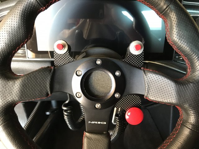

Two more to go before you are as cool as the guys w the high $ bracket dragsters. :giggle:
I guess I could add a couple nonfunctional buttons in different colors just make the spectators think I’m special. 🤓
2,226
3,824
Don't worry about my buttons :ROFLMAO:

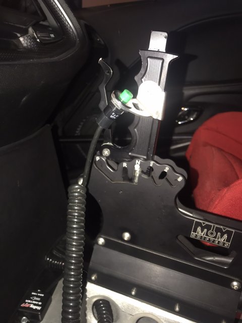

I actually do have another one I forgot about. On the shifter 🤗 61477BDB-6A62-4FD4-9BB7-8FC75A72DDC3.jpeg

That the scramble button for the turbos?
lol No I’m scared of this thing as it is. Transbrake/2-step, bump for staging and chute. The green one on shifter is line lock.
