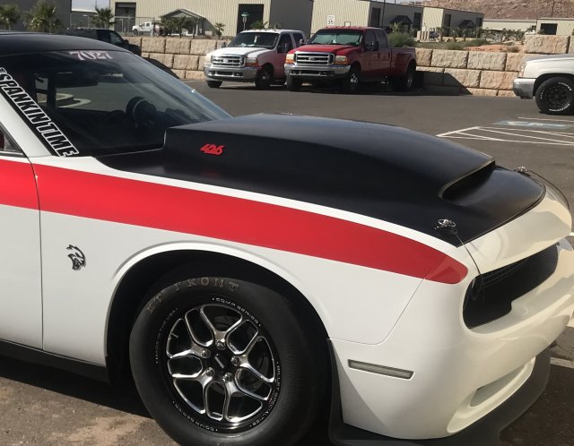

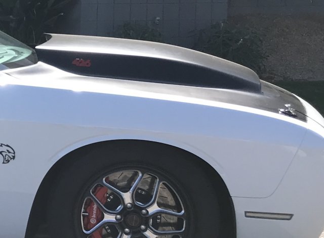

The ladder bar rear is done with the anti roll finished yesterday. It all goes to powder coat next week. Custom coil overs and Strange 40 spline axles are ordered. The fuel cell placement and tin work starts next week. The new 14” wing is being fab’d and the latest decision is to replace the hood and deck lid with Anderson CF. Redeye Racecars is a Anderson Composites dealer now, so we’ll be sporting some of their stuff. So…. Anybody want my cowel hood? It’s the fiberglass version that was sold by Kenne Bell. While off the car and being stored in my trailer… it fell over and suffered a couple minor skuff marks to the mat black wrap. Could be just touched up if you’re not particular. Otherwise it will need to be re-wrapped. $400 with the Mopar hood pins included. It’s at the shop in Vero Beach now. I’ll do a separate ad on that shortly. IMG_0805.jpeg IMG_1516.jpeg IMG_4251.jpeg

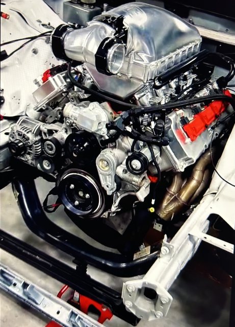

And the BIG news is…. I’ll be moving to Vero Beach Florida to be a full time member of the Redeye Racecars team. James Golden has made me the offer to become the “other” twin turbo Hellcat running with them at the events they will be participating at. My home in Utah is for sale and the huge job of relocating across the country has begun. In the meantime… the car will be returning to Spankintime for the new engine and final setup and tuning. Spankintime (Adam Montegue) will continue to provide the engine expertise going forward. Nobody better in my opinion when it comes to building one of these Gen 3 Hemi’s. The goal now is to put a stock frame Hellcat in the 6’s. IMG_7147.jpeg

And the BIG news is…. I’ll be moving to Vero Beach Florida to be a full time member of the Redeye Racecars team. James Golden has made me the offer to become the “other” twin turbo Hellcat running with them at the events they will be participating at. My home in Utah is for sale and the huge job of relocating across the country has begun. In the meantime… the car will be returning to Spankintime for the new engine and final setup and tuning. Spankintime (Adam Montegue) will continue to provide the engine expertise going forward. Nobody better in my opinion when it comes to building one of these Gen 3 Hemi’s. The goal now is to put a stock frame Hellcat in the 6’s. View attachment 144968
Welcome!!!!!!!!!

The ladder bar rear is done with the anti roll finished yesterday. It all goes to powder coat next week. Custom coil overs and Strange 40 spline axles are ordered. The fuel cell placement and tin work starts next week. The new 14” wing is being fab’d and the latest decision is to replace the hood and deck lid with Anderson CF. Redeye Racecars is a Anderson Composites dealer now, so we’ll be sporting some of their stuff. So…. Anybody want my cowel hood? It’s the fiberglass version that was sold by Kenne Bell. While off the car and being stored in my trailer… it fell over and suffered a couple minor skuff marks to the mat black wrap. Could be just touched up if you’re not particular. Otherwise it will need to be re-wrapped. $400 with the Mopar hood pins included. It’s at the shop in Vero Beach now. I’ll do a separate ad on that shortly. View attachment 144965 View attachment 144966 View attachment 144967
ll take the hood. Pm sent
Congrats man, that's exciting news! As someone that's also moved cross country this year, it's a pain in the ass but sounds like it will be well worth it in the end. Looking forward to more updates and how everything works out. I have a pretty good feeling I'll be moving from the Whipple to a twin turbo setup at some point in the fairly near future.
