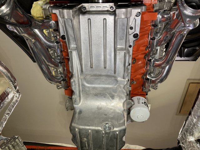

Lots of progress! I'm very surprised on the bolts hitting the pan. How much clearance did it take?
About 1/8” right at the top of the pan rail right in front of where the 2 rear bolts are. I would’ve taken a picture but my phone was dead and I was dirty tired pissed off hungry and just wanted to get it back on LOL

Am I the only one NOT impressed with our cast-aluminum oil pan??
Does anybody have any experience in reworking/finishing/polishing cast-aluminum into something that doesn't look like "poo"?

Actually I like it. My last cars had stamped steel pans. This is a huge upgrade but until you take the belly pan off you can't enjoy it

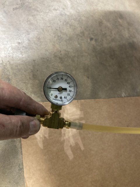

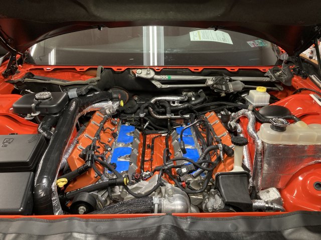

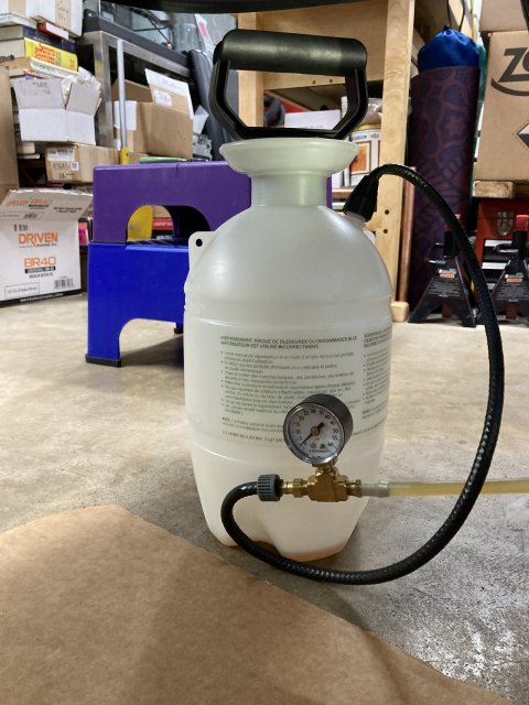

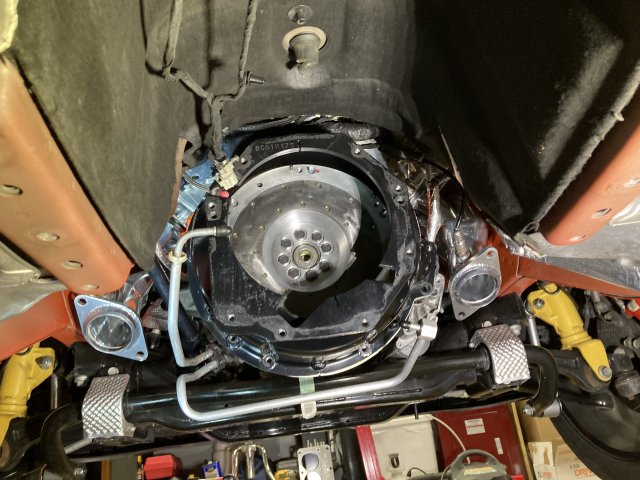

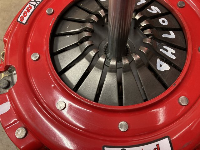

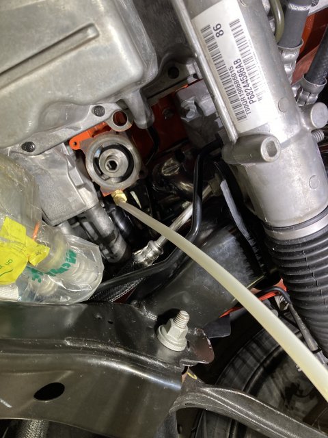

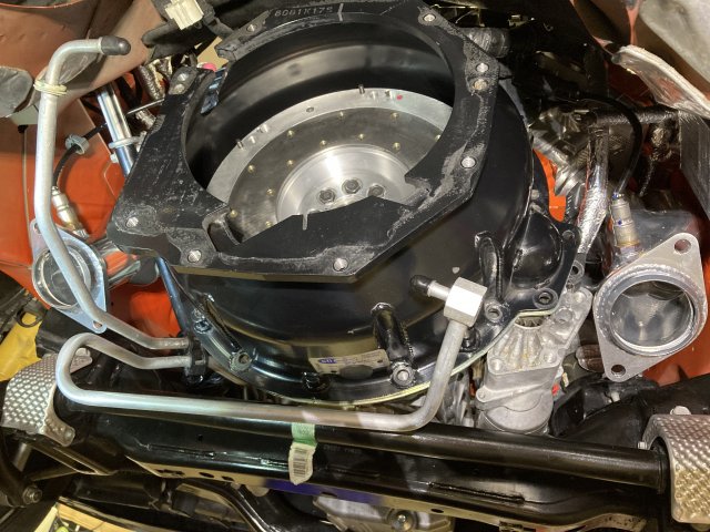

Engines ready for blower, dial the bell in then be ready for trans, maybe make start up for my B day!! Pumped 2 qts of oil in it through the filter until it poured out the top, rotated it over about 2 revolutions while it had 10 psi of oil pressure.

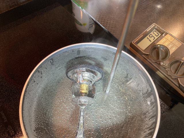

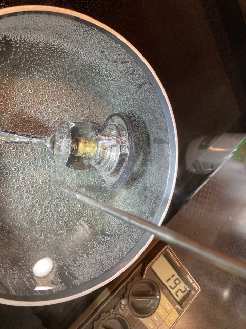

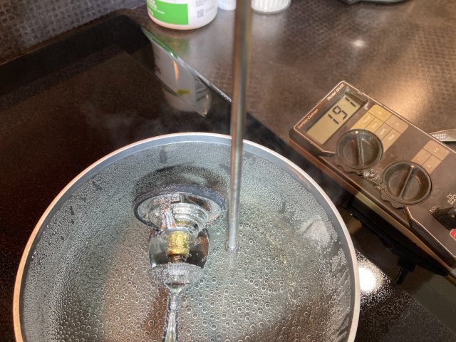

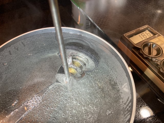

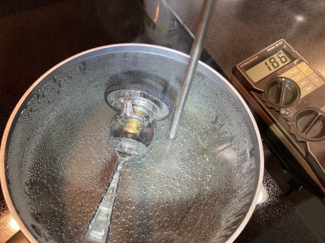

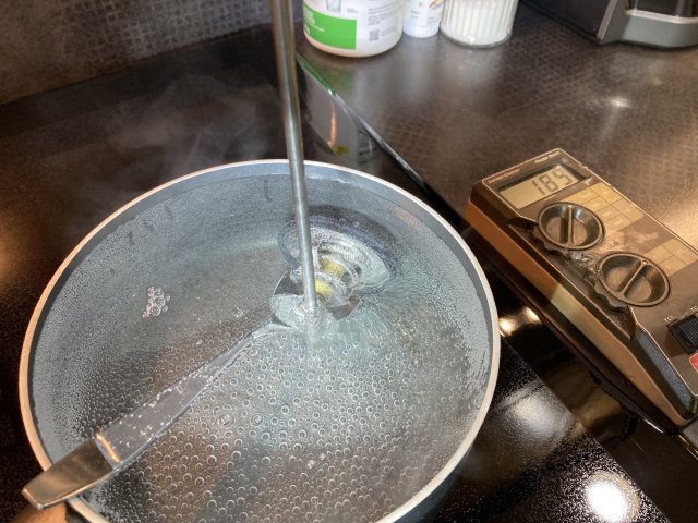

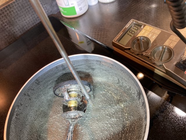

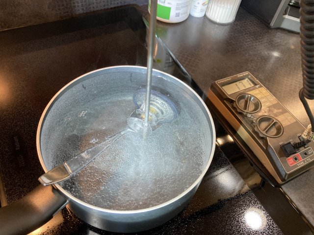

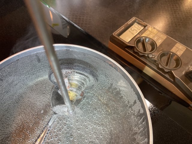

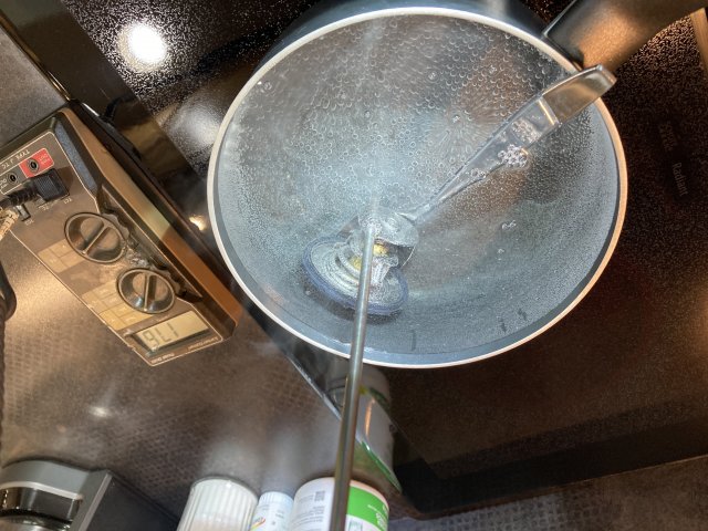

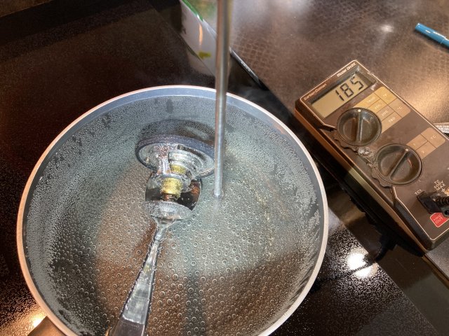

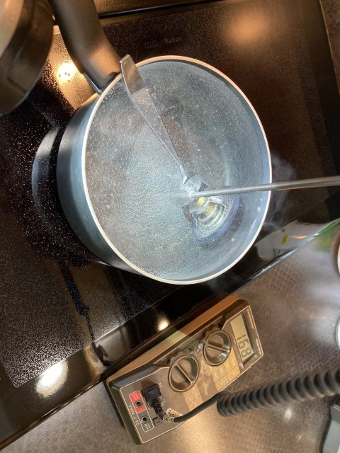

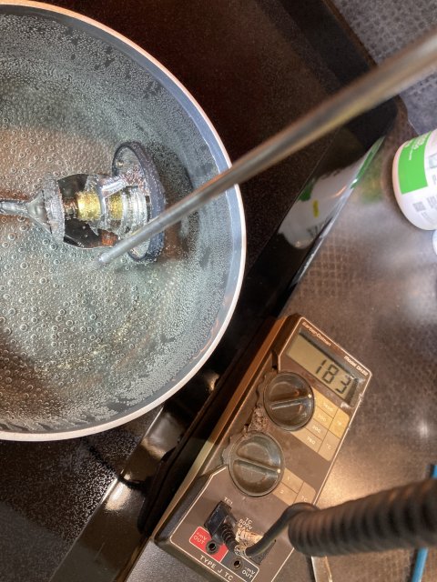

The Misimoto T stat started opening at 180 3E5B333E-6791-483D-BB9F-1768B9812B29.jpeg A8BE79D8-A855-464B-96D5-9A6E40743416.jpeg 1CB77D21-2492-423B-8859-006935342E78.jpeg 79483E5E-B70B-40C4-B6CE-81B16C27E590.jpeg 7F56A676-5191-4C43-901C-05C57DA1E732.jpeg 3C3A7FFB-6038-4945-9450-95A464590160.jpeg CC472590-34DF-45FF-80D7-68ADFDA37726.jpeg D076B4A2-8130-4ECB-B7B1-7A1CDF4E2D3D.jpeg 896BA4B8-F679-4A4F-AB11-F96BB33EC412.jpeg F37C12B7-D204-4111-BF0C-63DE51A66454.jpeg E51989F2-1DD7-4F7E-A2D7-1B263DDA9712.jpeg B0DADF1C-CEDD-4626-A662-6C650F438E9C.jpeg 57157A5E-3145-4E4C-9915-C0F9374CD069.jpeg 56695F65-BAA4-47D0-B9D6-9DB58C30E6FC.jpeg and by 190 fully opened, on the cool down side was fully closed at 179, pretty impressive, used it.

That's why I spent $50 on the Mishimoto instead of $18 on any brand X. They're accurate, reliable, and well made.

It's like a cooking show with no food:unsure:
That’s his DIY thermostat opener/closer. Definitely not the kitchen :cool:
