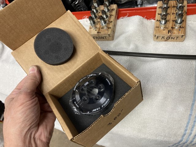

Speaking of fuel system, new fuel pumps arrived today.

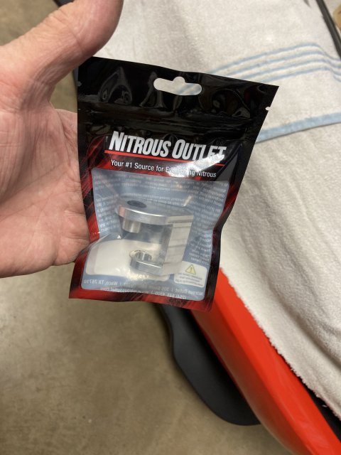

Along with a 3.00 pulley a buddy of mine sent me and that bracket from Nitrous Outlet for the insulator spacers. On Sunday!!

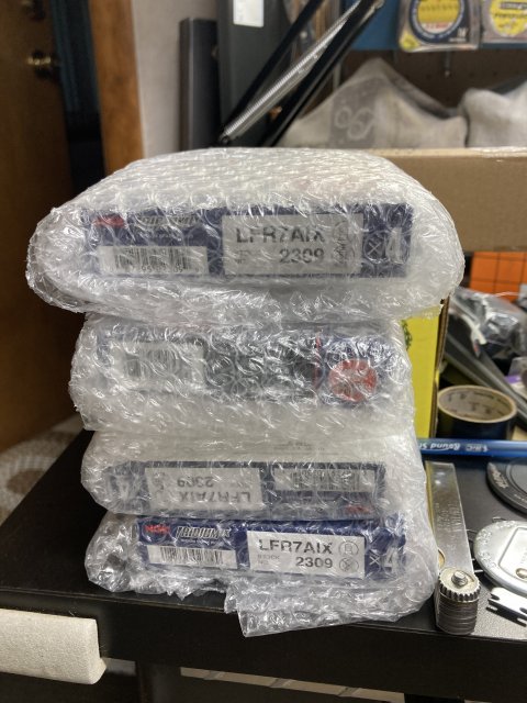

And 16 new plugs too!! :)

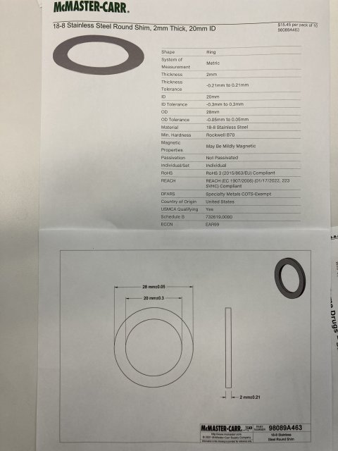

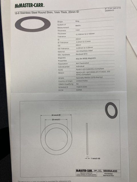

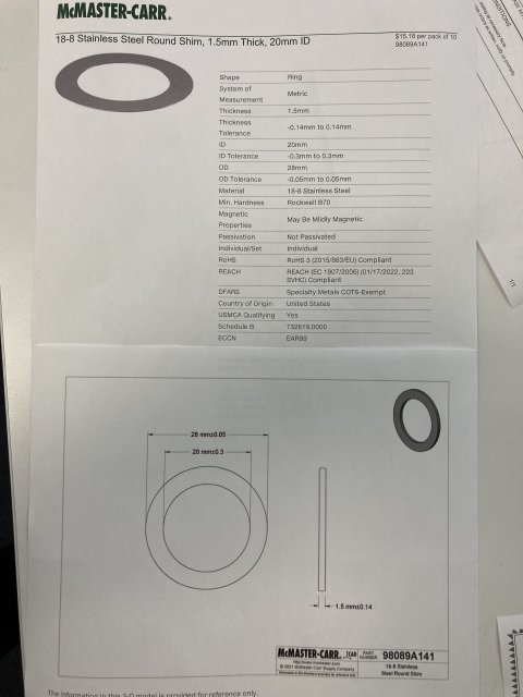

Those spacers for behind Litens pulleys, McMaster #’s below
F5C2E718-3CDA-4A84-884B-B989C2B16B28.jpeg C46D63F5-ED67-4805-93D7-26C2D7902C70.jpeg 5C1924D3-FAA6-45CF-8C10-442CD461E9E9.jpeg

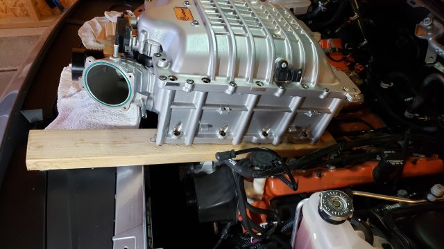

Being serious, they are just over 100lbs.
The trick for me was to lift up the front enough to get some short sections of 3/4" hardwood pieces underneath the front of blower and raise it up, then I could rock the rear up and get more sections of hardwood under the rear.
That got it up above the pins.
Then I was able to slide it forward on 2*4s.
Like so...
Then it wasn't so far away and I was able to lift it, pivot around, and immediately set it down on a table behind me.
