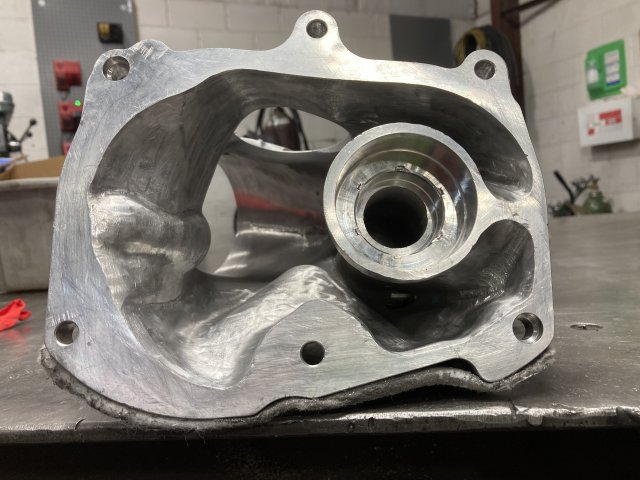

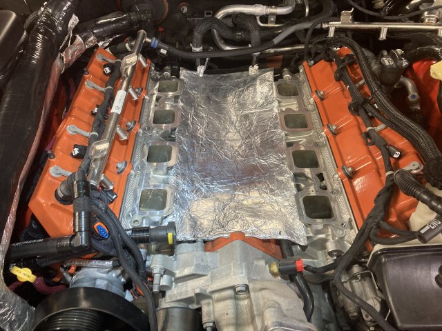

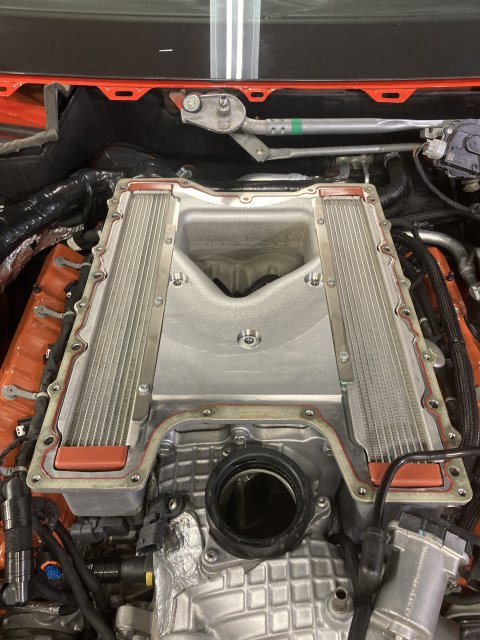

I still need to look for similar restrictions as found at the rail connections back in the pump area where the fuel line starts. I’ll be doing such in the next few weeks. In that last log posted my pump DC actually was not maxed at 89% for all of the top end of third and fourth like it was before the rails where opened up. I’m Working on my SuperCharger snout replacing bearings and opening the inlet up to 100mm to match the BBK TB to see what it nets. I tried it before in place of the Fastman 95 and it didn’t net anything, the stock snout inlet is 95mm so that may have negated the bigger TB. A ceramic balled hybrid bearing did not last long at all on the front of the snout, I’ll be using a high grade total 52100 steel SKF bearing this time. The balls where all pitted in the front 6204 bearing, the 6203 back at the coupling was fine, they’ll both be SKF this time. This hopefully was my knock issue. I also found SC heat exchanger had a slight leak right over # 2 cylinder, see the purple spots on #2 intake port in picture? Replacing both HX’s with spares I have. The SC was spotless inside, UPR catch cans are GREAT!!

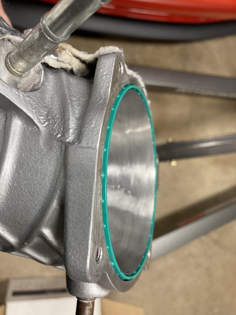

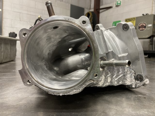

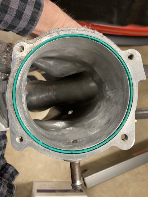

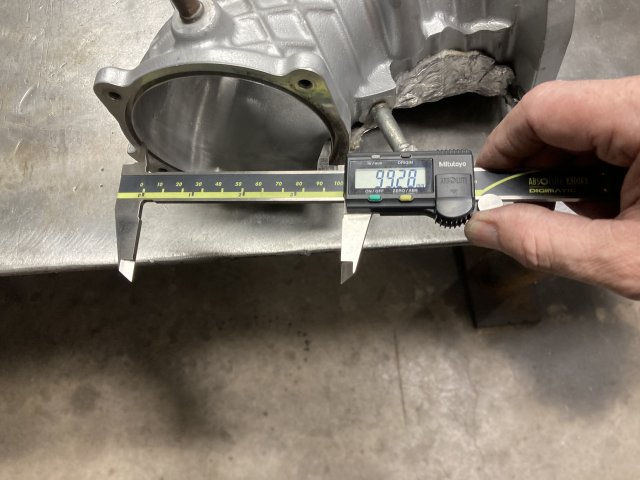

They are set up stock yet and very sensitive, I’m hoping that’s what was triggering them. While off and apart I opened up the inlet to match the BBK 100mm TB that’s going to be the next addition. It’s a hair under 100mm as I wanted to retain the factory oring groove but with the BBK attached it’s a near perfect smooth transition from T to snout. 7C4EA77C-268D-4A8A-BB75-D47CD1CDD4BB.jpeg D9D47151-D7F7-4A9B-9211-59F11FB5CB9D.jpeg 5406C47F-B861-4B6C-87B2-64269D47090A.jpeg

THANK YOU!! Unfortunately I shake like I have Parkinson’s but having the proper burrs and sanding drums does wonders at covering it up LOL. Only took about 2 hours start to clean up. Plus I grew up with the only way I could afford porting, port matching, etc was doing it myself lol. Aluminum is easy, old cast iron heads now that was a task!!

They are set up stock yet and very sensitive, I’m hoping that’s what was triggering them. While off and apart I opened up the inlet to match the BBK 100mm TB that’s going to be the next addition. It’s a hair under 100mm as I wanted to retain the factory oring groove but with the BBK attached it’s a near perfect smooth transition from T to snout. View attachment 36443 View attachment 36444 View attachment 36445
Good job but Man that's a thin lip, I hope it still seals good ?

It seals on a oring that goes in the groove, the thin lip just keeps it in place, it’ll seal perfectly like this. I’ll post a picture later with the seal ring in place and you’ll get the idea what leaving the thin ring does.
3,662
8,603
Thread Starter #99

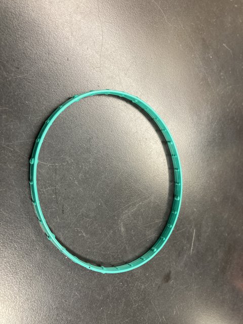

Here is the intake end with oring gasket installed (green thing). The only aluminum face that does any sealing is the one in the bottom of the groove, the sides just capture the oring and keep it in place, then the other face of the oring seals against the back side of the throttle body. If the groove is machined out such as done to open it up for a 105, 110, 112 mm TB then this whole groove is machined out and a traditional flat paper type gasket is then used for a seal on the outer flat aluminum surface, not ideal as it does get very thin when that’s done especially when you go to 110,112 mm it’s about gone.
6FBAC168-319F-450E-ACEF-C864D2052362.jpeg 08015BF1-AD75-48F2-87D0-EA67416E4587.jpeg A2CFD6FD-4FC6-4254-9515-086005602216.jpeg
5,189
9,649
View attachment 36474 View attachment 36475 View attachment 36476
Yeah, I thought there was just enough lip left for the O-ring but it looks like if you go any more it will suck that O-ring in.
